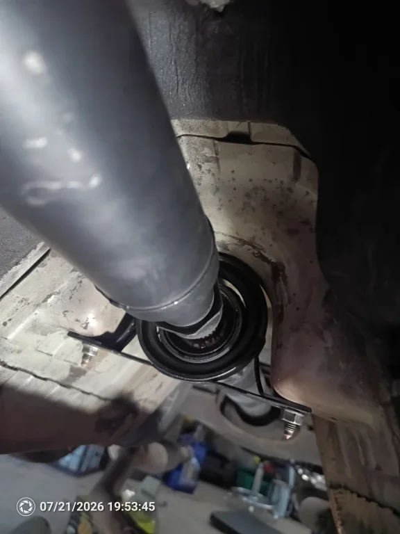

After I did the transmission work I realized I had damaged the drive shaft center support bearing. The car was still drive-able but I could not give the car any torque without the driveshaft trying to escape. So, instead of replacing the center support bearing I got a really fancy one.
The original versus the super fancy one:
You can see the tear in the original bearing. The fancy one uses the center piece from the original. It gets squeezed insde this very large housing. The possible downsides are more NVH and more of a snappy peddle response. Sure, why not. (I didn't notice anything, but over time I convinced myself that of course it's better...because that's what one does after spending a bunch of money.)
