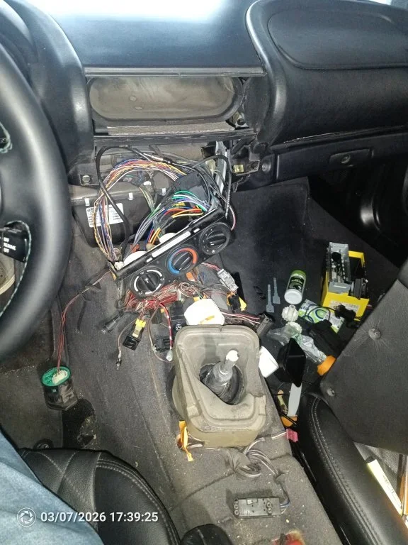

I then decided to completely remove the center console and address the cracked plastic shifter surround.
The plastic trim around the shifter is known to be a weak spot. It is extremely common to see the plastic around the AC buttons to be cracked or missing. Here is what mine looked like.

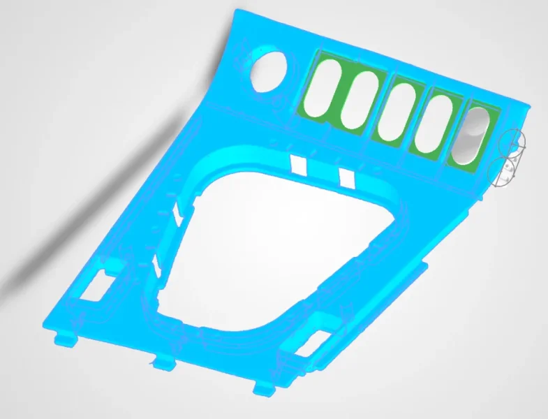

They are also crazy expensive to replace! Even 3d printed ones. I decided to try and salvage what I have and see how that turns out. So I scanned the trim and buttons in with the idea to replace them with an aluminum surround. This was a great learning process for the scanner and getting familiar with SolidWorks.
The initial scan of the trim.
Then created a something that I thought would work.

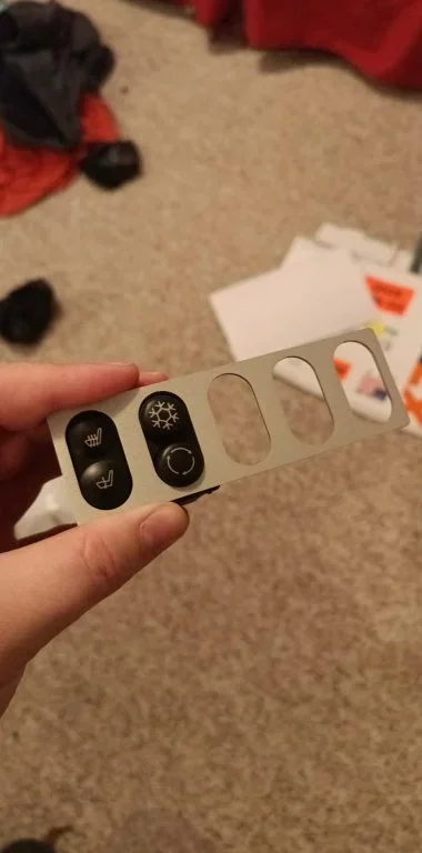

Next step was to send the design off to SendCutSend and got some nice clear anodized aluminum pieces!
They fit great! This might actually work. I then assembled everything, but not before vinyl wrapping the stained & scratched plastic. I did this to both the shifter surround and the stereo & gage pod trim.

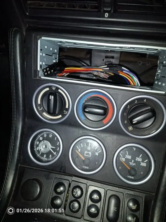

Then tossed it all back into the car!.....Right after I finished modifiying the stereo..

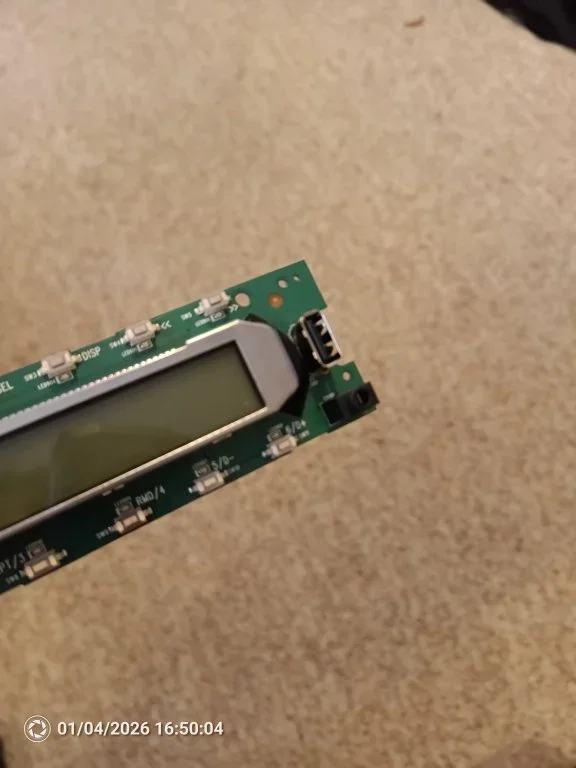

As I mentioned in earlier posts, I turned my clock into a phone mount. I also replaced the cigarette lighter with a USB charger. Since my stereo has a front facing USB port I decided to take apart the stereo and solder a USB cable to it and extend it out the back. Why do this? Cables are ugly. This reduces cables in the cabin by connecting the phone to the stereo through the charger in the cigarette lighter position.
This is the stereo face and USB cable. The next step was just to add a USB connector to the other side.
Then I punched a hole, added a nice grommet and ran a cable out of the back. I should mention I also hot-glued the cable to the connector inside the head unit.
What we have left is a pretty clean setup. I have a dedicated 4 inch (~10cm) USB cable to jump from the cigarette lighter position to the phone mount just above it. Nice and clean. You can see here that the aluminum looks pretty good. Ignore the missing volume knob and vent....I got ahead of myself and took a picture before I was finished assembling.
