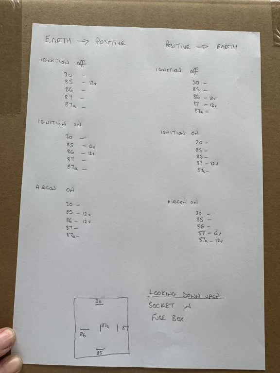

OK so I get,
Ignition off - the only pin with 12v is pin 30, nothing on the others.
Ignition on - the only pin with 12v is pin 30, nothing on the others.
Ignition on & Aircon switched on 12v on pin 30 and pin 86, nothing on the others.
Ignition on & Aircon switched on & Engine running 14v on pin 30 and pin 86, nothing on the others.
At least my alternator is fine :whistle:
Happy to recheck if it is not what you expect, got a bit soggy on the drive in not so sunny Bolton.

I’m hoping that pin 85 changes to earth giving -12v from the positive terminal when you switch the Aircon on?
(No rush - I’m not back until Saturday.)
MickyG,
Please disregard post 161 completely.
My mistake I got the relay positions confused when turning over the relay to check terminal numbers.
I have now checked again (double & triple).
The image below should help, the relay terminal numbers are how the socket looks as you look directly at it with the relay removed.
I hope that makes sense?
Earth to positive column = earth taken from chassis/body and positive probe into terminal number indicated.
Positive to earth column = positive taken from Jump start terminal and earth probe into indicated terminal number.
Again I hope that makes sense.

Brilliant - thank you. I’ll eagerly test my car tomorrow

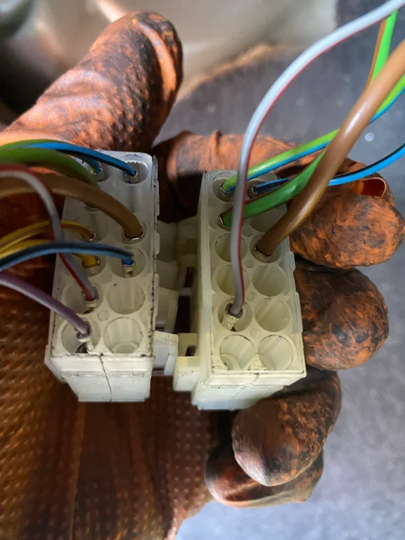

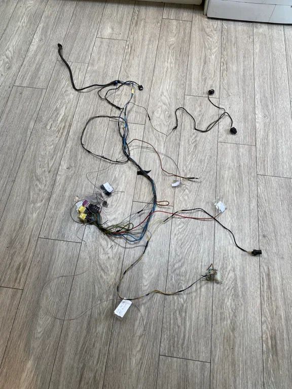

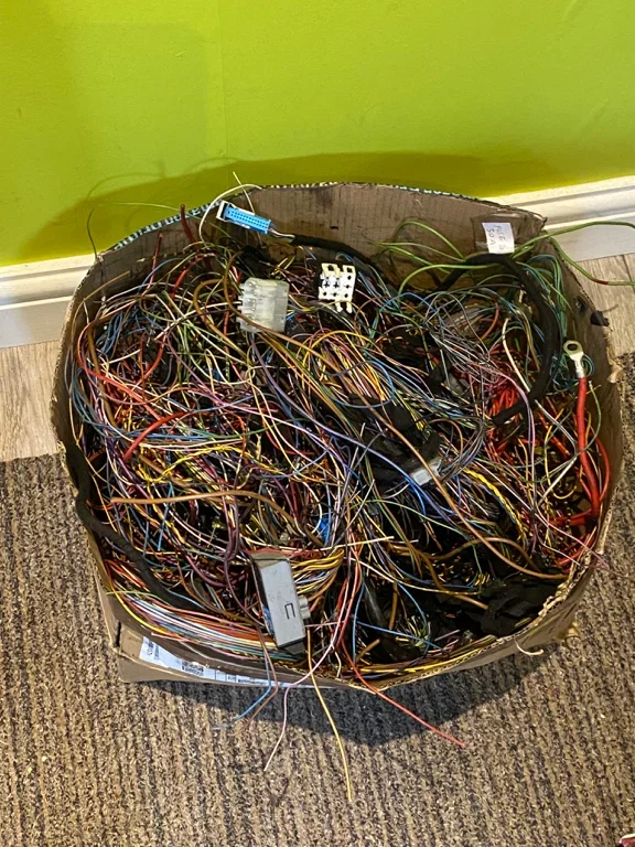

Very impressed…with your patience to get this done. What’s the build date on your 2.8? And well done for getting this done 👏🏼👏🏼👏🏼
From a big bundle of wires - the entire front loom - I've separated the AC loom, done some soldering and worked out what goes where. Only four skinny wires go through the bulkhead and fit into the existing wiring plug from the heater unit into the car loom.

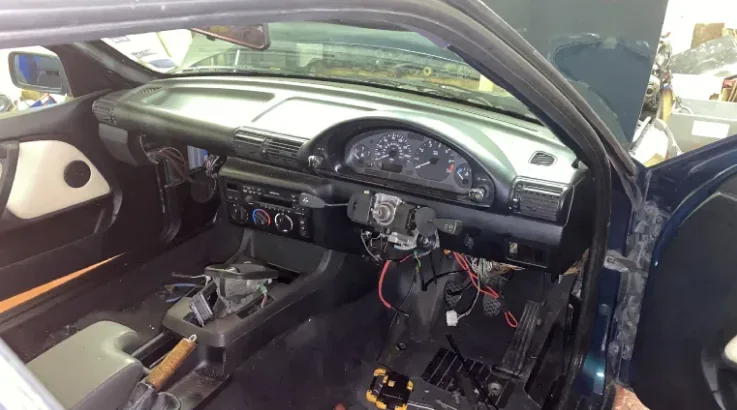

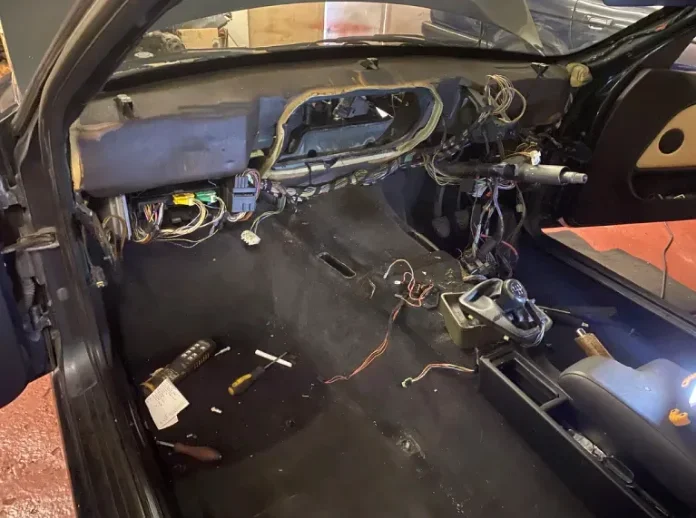

I started today at 8.30.....by 9.45, it was all apart.
Refitting it all with the new AC heater box took a lot longer. By 2 pm it was at this stage. It's now reassembled with a working blower motor. Next job is all the under bonnet stuff and starting on the wiring. That'll be fun.

Presumably removing it from an E36 compact dash is much easier than from the Z3? You appear not to have had to remove the upper dash?
Did you remove the Z 3 upper dash?
Whatever you did you’ve made good progress.
The only bit of help I can offer is the ECU and car control units do not require programming to run the Aircon system if you are using the Z3’s ECU.
( I spent an eternity chasing wiring circuits and researching if ECU programming was required - eventually my testing suggested the pressure switch was faulty, and finally swapping out the control module by the side of the HVAC unit gave me a working system.
Do you have the complete wiring diagrams for the Z3 to work from?
The whole dash came out. I’m having to add all the AC wiring but I have the E36 Bentley manual.
