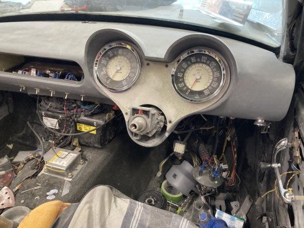

I have been mostly pre-wiring my new dash in the last couple of days! :)
I needed to test my wiring, so I tested the pretty gauge lights first (as they are interesting).
I had a small problem with one bulb holder, but it was quite simple to 'adjust'.

One thing I have noticed whilst checking my instrument wiring is that ANY feed to the speedo (even just the illumination feed) lights up the odometer figures. It isn't just the backlight on the LCD screen, the numbers power up in black aswell. Doesn't seem right to me. I shall be asking John at ETB at some stage.
Your dash lights seem very bright. Perhaps they are so bright the light is being bounced all over the inside of the instrument.
Perhaps try using a variable resistor to change the brilliance, then either use a variable resistor or use a fixed resistor of the required value.
My dashboard lights are not as bright as yours...

They're not. It's just the way the phone picked them up on the camera. They are standard ETB (VDO) gauges with standard bulbs. The resistor coil in the Z3 light switch dimmer will adjust them anyway. I am lucky to have one that hasn't crumbled to pieces. ;)
