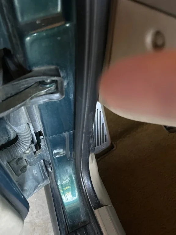

    colb replied to the thread Door hinge loose.
    Its the door check strap, sounds like a worn pin in it clicking diagram here item No 2 and the pin is 4...

    Nuieve replied to the thread Door hinge loose.
    Here’s a video: https://streamable.com/s2mfhw

  • Duncodin
    Duncodin replied to the thread Door hinge loose.
    Can't see the top hinge in the picture. Can you get a better picture of the top hinge? If you're concerned about that thing in the...

  • N
    My door is making crunching noises when opening. I can see the top hinge is wobbly and not tight. Anything I can do myself or is this a...
