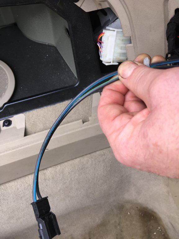

yeah i know what you mean,i can feel what feels like a tie wrap in the well holding them,i can only feel 2 wires going into the pump,which is basically a 12v drill motor,so one is + and one -,are you saying there are 4 wires coming off the pump going to the module or you are not sure what colours they are and only 2,thanks
You are correct, there are only two wires ,
The module just reverses the polarity for the opposite direction.
What I meant was, as in the photo, one wire looks to be blue and black striped, and the other wire looks green and black striped, but I can't make out if there is also a white stripe as well.

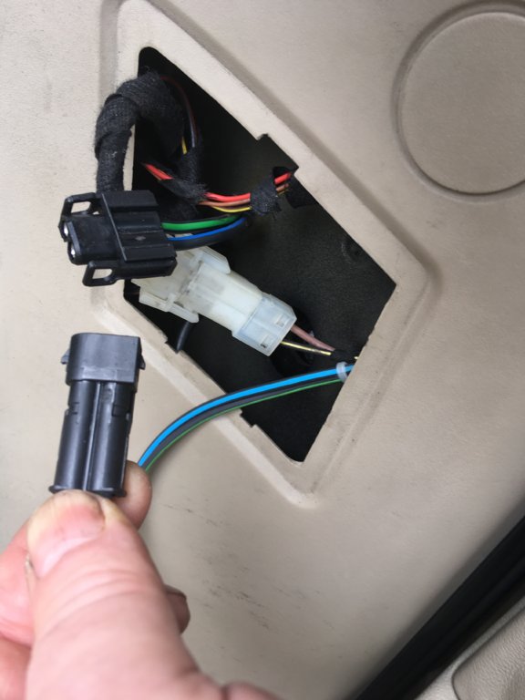

hi,chaps i can confirm the two wires that go to the pump are accesible from behind the small grill behind the passenger seat,the one in my hand goes to the pump,easy enough to put 12v across them to confirm your pump is dead or alive,in my case dead !!.
i would put the roof slightly open as you dont want the pump trying to force the roof shut,when it is already shut,if you connect the wires up in that order,if you know what i mean,cheers all

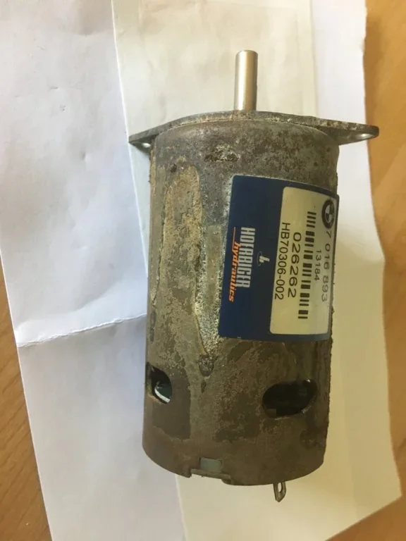

found this on ebay,£13.26 delivered,got me thinking,anybody know what the bmw motor rpm is,would bmw spend a fortune developing a motor for the roof or did they use one that was widely available?:)

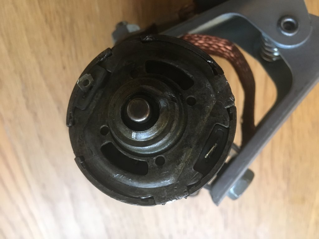

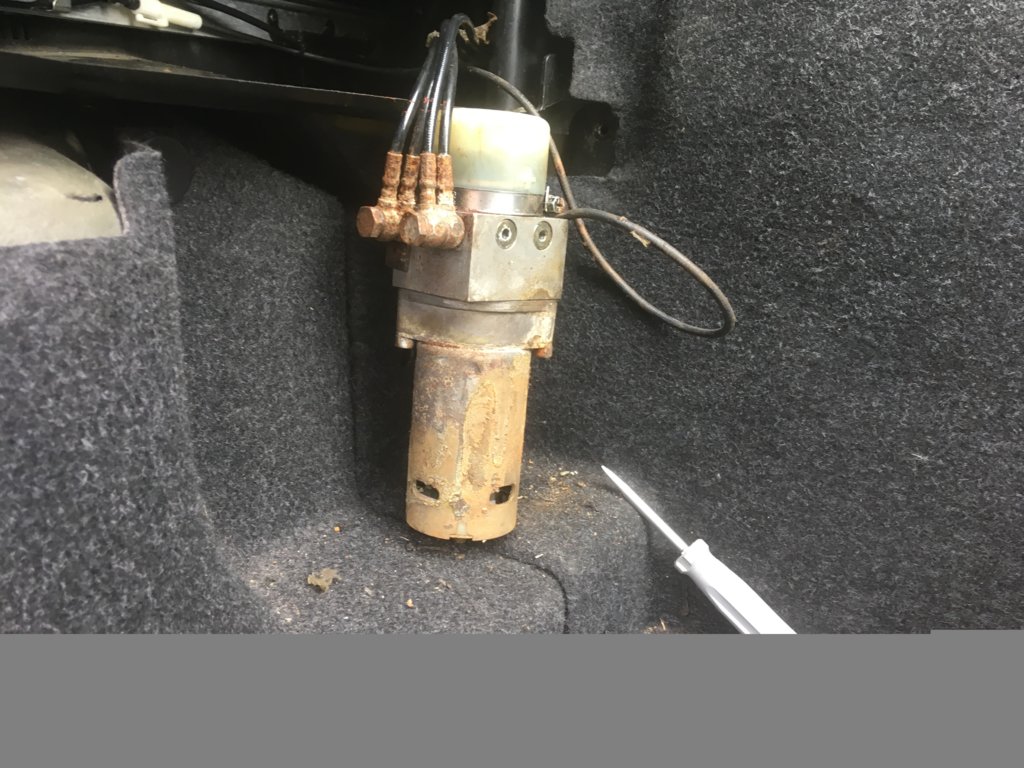

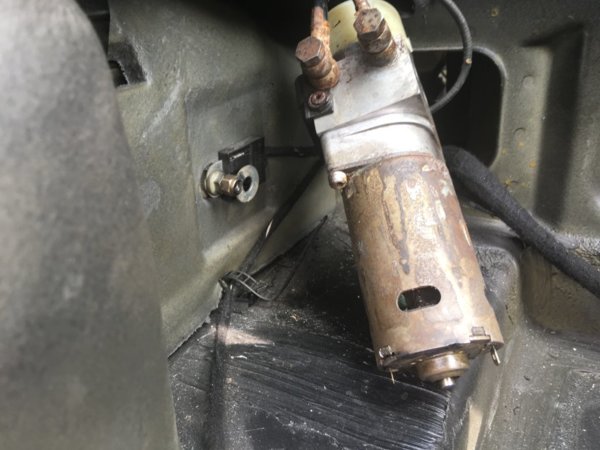

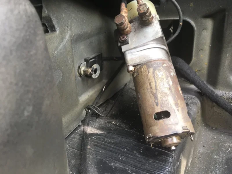

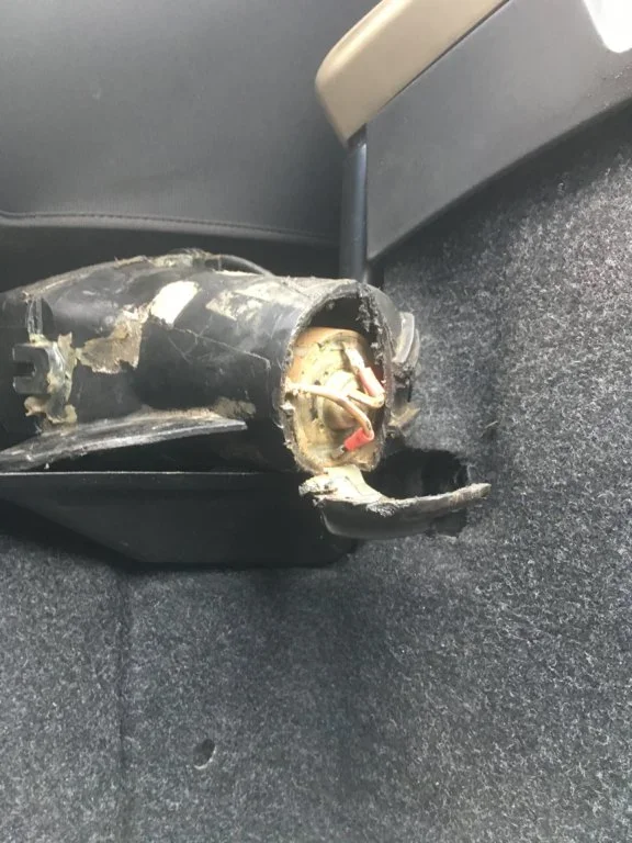

hi chaps,update on the motor relocation,

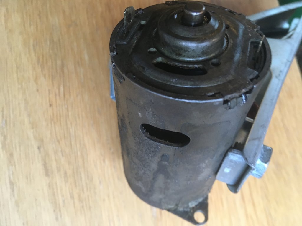

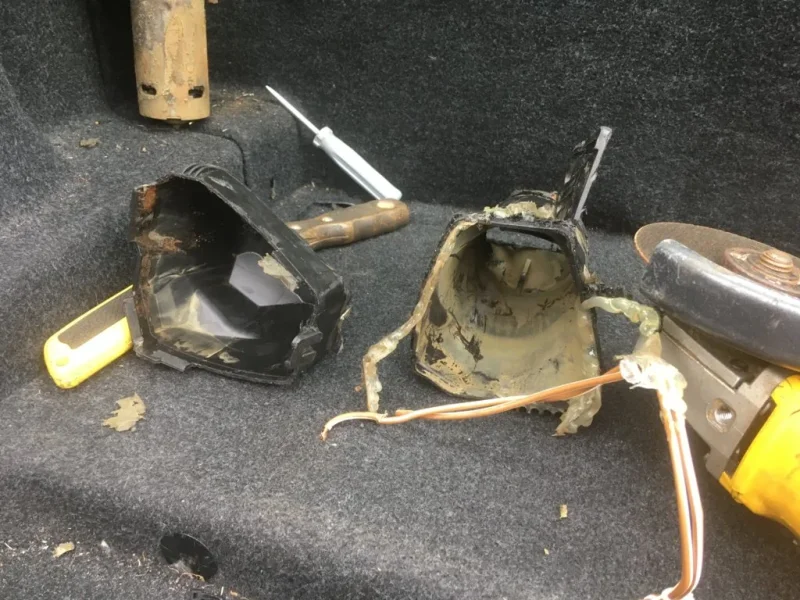

so i managed to pull the motor and plastic housing into the boot,but had to cut the 2 electrical wires to allow it to come to where i could access it with my trusty angle grinder and cut the plastic bottom off.
i could then push the bottom of the motor upwards holding the bottom half of the casing,this then forced the top of the casing off revealing the pump and motor.
i detached the motor by undoing the 2 allen bolts,putting 12v across it,it was dead and white smoke came out of it,anyway decided to take it apart

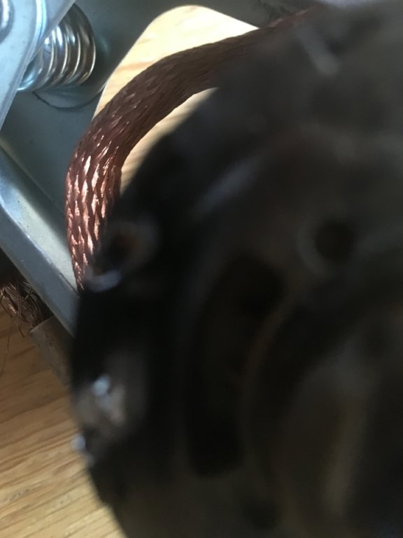

holding it in a vice i managed to get the end/bearing plate out by hitting it upwards with a screwdriver,it is crimped to the casing,when that is out you can get the plastic/brush plate out,i gave this a good clean with wd40,brushes etc looked fine.
i then removed the armature and shaft,this was basically jammed with chunks of rust etc and shorting out,
a clean up of the inside with scotch brite and hoovering the debris out with a thin tube taped into the nozzle of a dyson,
re oiled the bearings and reassembled.
i had to file the crimps on the casing to get everything back in,tacked the back plate to the casing with a tig welder,to hold every thing together,
put 12v across it and hey presto a working motor,smooth as silk
so reattached motor to pump and rewired it back to the connector behind the passenger seat.

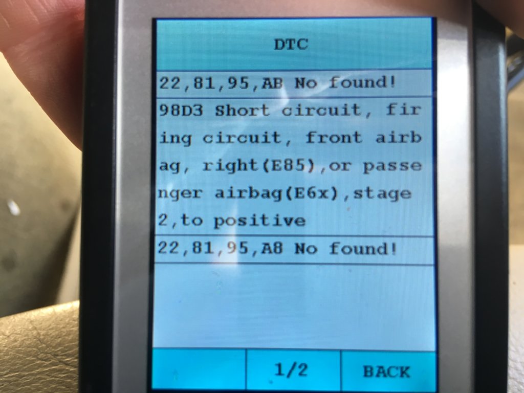

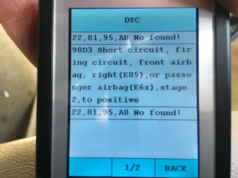

next saga to get the airbag light off,anybody point me in the right direction,with this error message,will try connectors under seats and occupancy sensor mat first,cheers all
