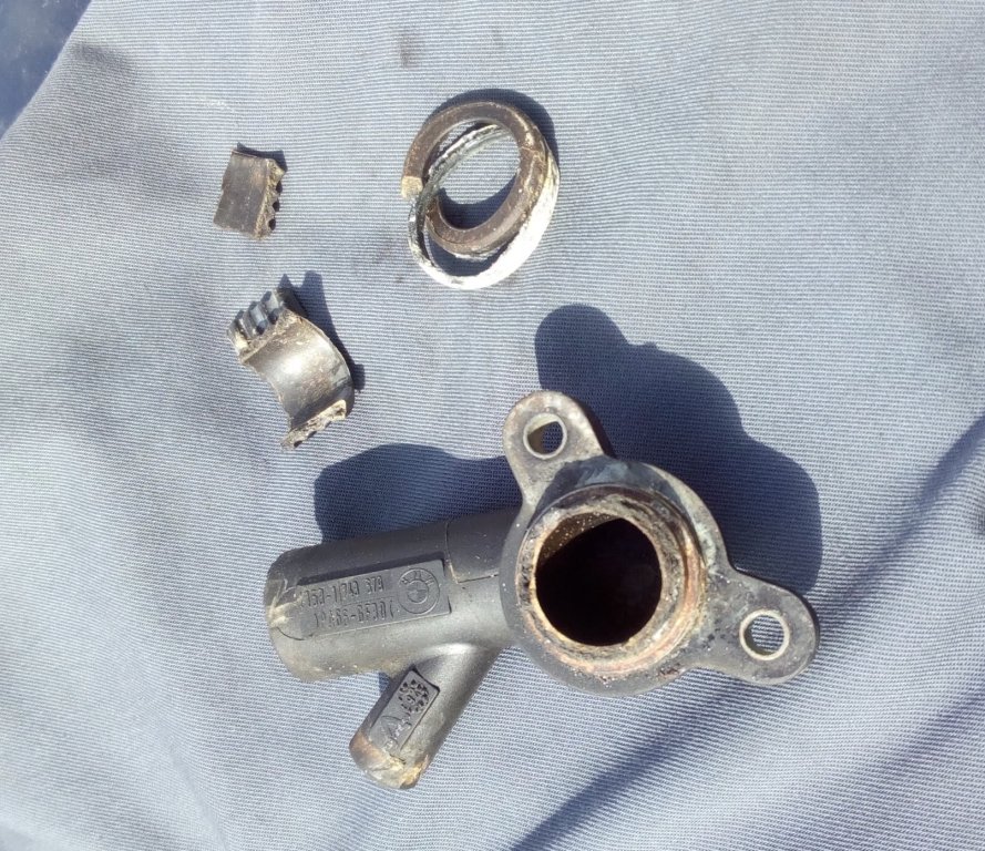

This is the water pipe connector. Fits into the head at the rear, right up at the bulkhead.

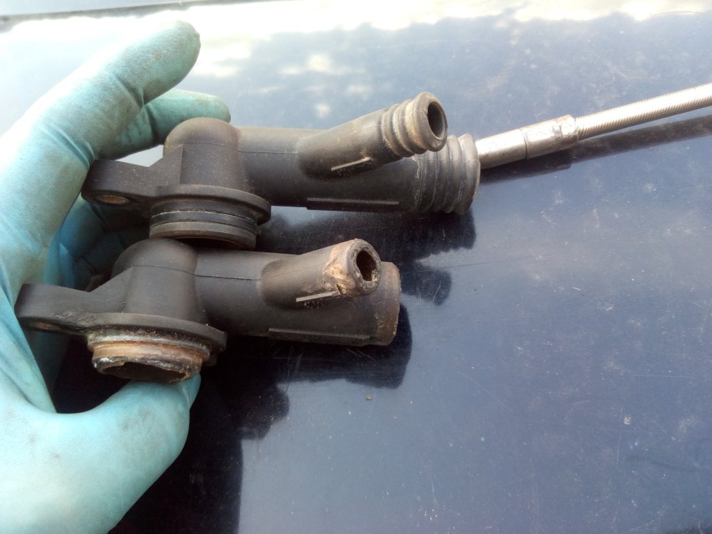

Pretty sure that was the one came out my sons M43. The thermostat jammed shut and blew the head gasket, but we discovered this was cracked whilst stripping it down. As you can see the plastic was so brittle it just came to pieces.
Replaced them on the other 3 cars we’ve had as a precaution. Given the state they were in, a thermostat and that pipe would be the very first things on my list of replacement parts.

The pics above ‘98 e36, M43 170K miles, ‘99 e36, M43 we can’t remember the miles, change was precautionary, was very aged but solid. My Z3, ‘98 M44 116K miles, dried out and knackered, very glad I changed it.
