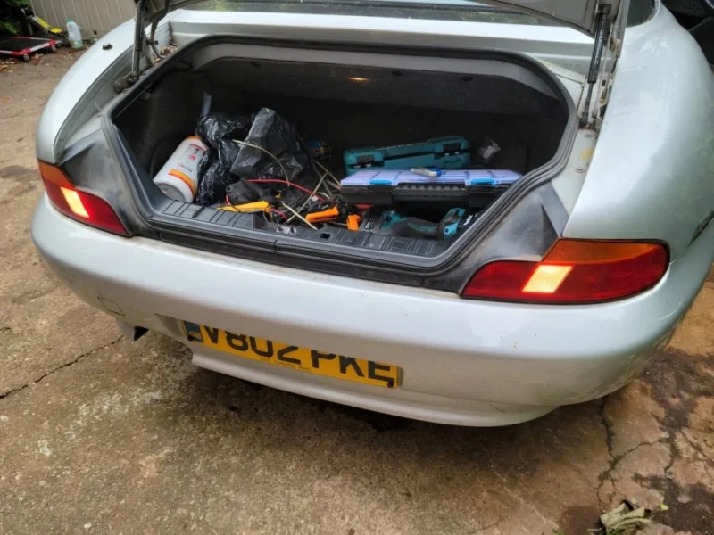

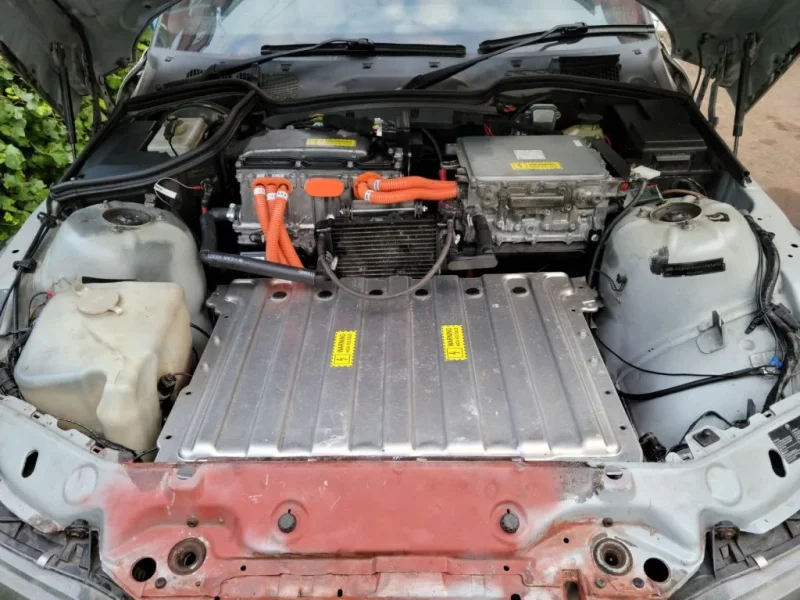

Reversing lights working in the image below (pre-boot tidy) and under bonnet shot (post-tidy).

The under bonnet picture looks very tidy Tom. Hope the test goes well.
