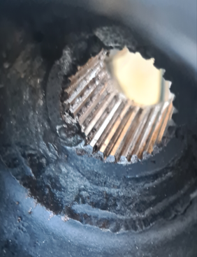

Started off with brake cleaner and a small screwdriver to clean the grooves out.... then a liberal coating of copper grease
Those of you that remember the nightmare of me trying to get the driveshafts out 2 years ago !..... well it was time to revisit my nemesis.
The damage is the result of me heating, hammering with a punch; hammering with a cold chisel; punching it; kicking it; swearing at it...doing everything to get the nut off as I had rounded it off... eventually I managed to drill it into several bits with a Dremel carbide bit.
You may think that's too far gone and I should just by a new hub......... but... oh no... this won't defeat me...
knocked the high spots off with a Dremel rough drum
that took care of the proud bits of "mushrooming" metal... now for the grooves
for this I used a carbide bit on the Dremel, to drill out the grooves..
started out like a WWI crater in the Somme
but with the Dremel bit... I ended up forming new grooves
and to my eternal relief.... they're both in !!!.... nuts are only there so as not to lose them... yes I have the anti rattle washers so will put those on an torque up another day

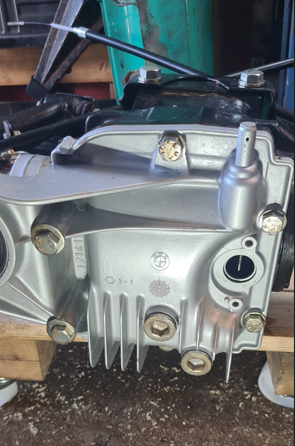

anyway.... thought I'd carry on emptying boxes by putting more parts on the car.....dug out Brembo brake hoses and new ABS sensors, plus a nice crisp diff gasket...

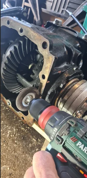

Cleaned up the surfaces on the diff and the plate.... quick go over with a wire wheel
Then I considered calling a mental health first aider... as I couldn't figure out why the holes weren't lining up, and that there were more holes in the Diff than in the gasket o_O o_O :whistle:
Given there are only 6 bolts but 10 holes, left me questioning the origins of the universe.......I tried not to think too deeply about it and just filled the holes with the bolts I have !!
As usual for me now, added a touch of Optimol thread paste
et voila... and as @Mazza learnt, I went in dry with the gasket, but I haven't torqued anything up yet just in case I've got it horribly wrong....

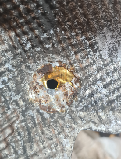

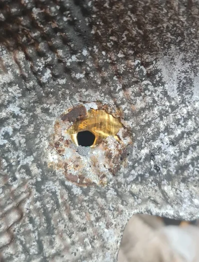

now then... for the rear heat shield, the holes had blown through so I had to get creative..... :whistle:
Now stick with me here.....
I got a old tube of disinfectant cream and cut it into three parts.....
Cleaned it all, folded each part over on itself, glued the inside and pressed it in a vice.. this gave me then a strong(ish) metal patch.... which I then glued over each damaged hole.
and this is the front side with new hole...
and now back in place nice and secure
