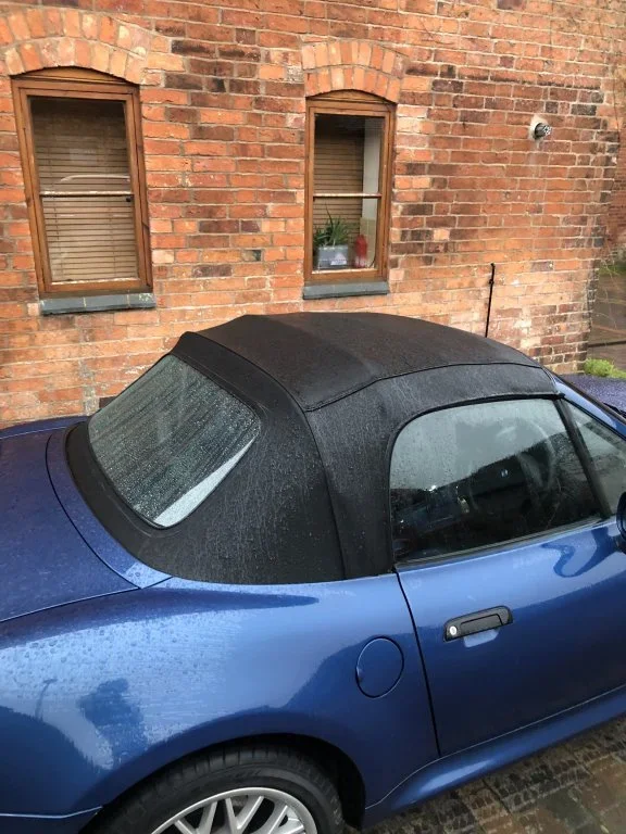

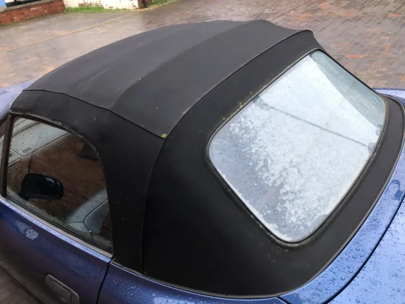

You either get lucky with the screen replacement or you don't. The ends of the zip are open with no starter like on clothing. The ends fray, you have to get the 2 sides aligned on the right teeth and it can pull apart as you go round a corner. The roof may be shrunk and difficult to tuck under the piping. The stitching can need doing on the roof.
That said others will tell you they have done it successfully and are happy with the result.
Plus with a new roof you get the rear bulkhead professionally sealed up from leaks and a spanking new roof. And if you have a headlining it can go moldy under there so that gets a refresh too.
And you get to spend 2-3 hours in Swansea ;). I recommend the Potters Wheel Wetherspoons with the old blokes supping their pints. Proper Welsh folk :) Of which I'm not one but as you'll see from my location I spend half my week living there.
Thanks for the info pal, have just been out to take the parcel shelf carpet out as it’s quite damp after yesterday’s downpour. I think it’s safe to say that the roof may have shrunk in the bottom two corners of the screen so it looks like i’ll be booking in for a replacement roof and screen as I can’t really see that just a screen will do the job. With the difference being a couple of hundred quid it’s not worth the hassle.
Will give them a call and try to get booked in, if your going to be around swansea around the time the milky bars are on me! Thanks again.

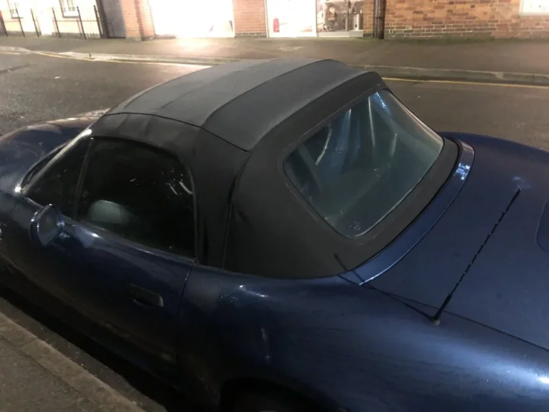

So a little time has passed since the last update and with that the wallet has become a little lighter.
The roof has been sorted thanks to Jack Smith’s of which I highly recommend, for the decent price he charges and the time it takes if your roof has any sort of leak there should be no questions about wether or not to invest in a new roof. To have a roof with no leaks is priceless! Just need the weather to brighten up so i can get it down.
