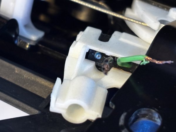

Spent a couple of hours addressing this today. First off I checked the boot light connector. 12v present but no continuity to earth - very likely the left-hand soft close loom identified by others on this thread. Stripped the boot lid down, stripped the insulation back and...bingo!
Black wire was broken, green came apart with the lightest of touches, blue was good albeit exposed:
Right-hand loom didn't have any broken wires (yet) but was deteriorating:
Soldered up the left-hand wires, insulated with heat shrink and relooomed with fabric tape:
On the right-hand side I just insulated the exposed wire with electrical tape and reloomed:
Put it all back together, worked a treat
:thumbsup:

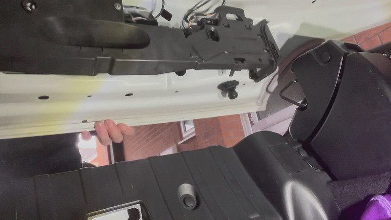

Took a couple of videos from inside the boot of each latch - you can see how the loom moves when the boot opens or closes.
LH latch:
Imagez4 boot left by Ian Conuel, on Flickr
RH latch:
ImageIMG_1265 by Ian Conuel, on Flickr
:thumbsup:
LH latch:
RH latch:

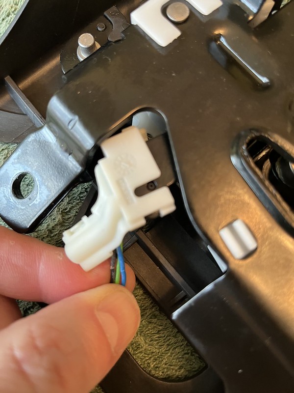

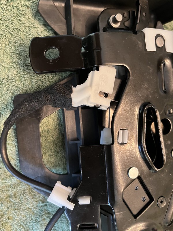

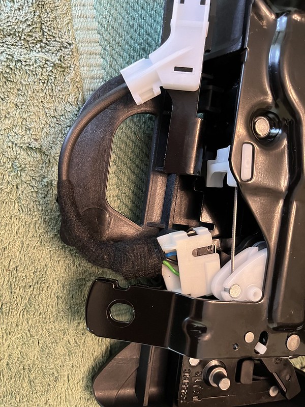

Thank you so much. This was great help.
I’ve dismantled it all, and looks like it’s already had an attempted repair by a previous owner.
I’ve found that the blue wire is completely cut right at the white loom. Any tips on how to fix this, how to get the white loom off to get the remaining wire out?
