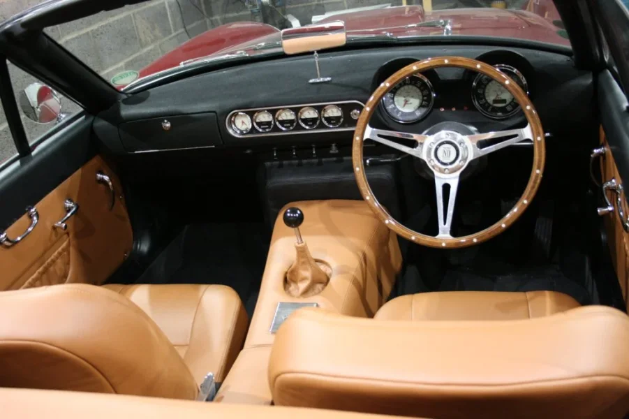

The dash look good. Very good.Time to add the dashboard to the build thread. After more than 6 months it's still not finished but I'm sick and tired of it now and need a break to work on something else and come back to it. (Maybe)
The 507-ish rebody, btw, has no dashboard. The only option is to keep the z3 interior or roll your own. I really didn't think it would take so long to roll one.
This will be like marmite. Like it or hate it. I really dislike marmite BTW. But I really had to get shot of the Z3 dash in my rebody and I really didn't fancy the idea of rewiring instruments etc. So my design keeps pretty much everything as is. Even the headlight switch and wiring is exactly where it was.
All previous dash pictures have some Ai work. This now though is really how it is. Warts n all.
ToDo.
Glovebox. The original underdash glovebox is still in place but I'd like a '507-ish' lid in the front of the dash. The little slot in the centre console below the radio is where heater control sliders will go and the round knobs will be replaced with gauges/dials.
On the 507 that rectangle above the radio is a 7" loudspeaker. On mine that'll be a 7" LCD display for satnav and diagnostics covered/hidden by a dummy speaker lid.
As.I said. Marmite.
If you are willing to do the wiring for additional gauges in place of the heater controls, why not change the main dash dials?
Even if you have the originals re-faced, it will look 'complete' IMO.
I have seen a lot of 'Z3 replicas' with re-done interiors, dashes, centre consoles, etc. But if they keep anything 'BMW Z3' it detracts from the overall look and looks like they couldn't be arsed to see it through.
You have spent so much time and effort on starting the interior change; you need to see it through and change the lot, or it will always look like half a job. In my opinion.
Even though my speedo is playing up at present (and seems no-one on the planet can help), and it is really infuriating me, I would rather have a 'period' speedo that doesn't work than a working BMW one! I would really like mine to work, though.
