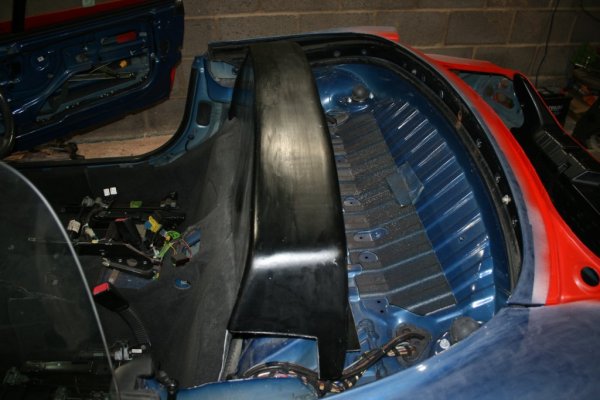

View attachment 355417Although. Grey cells working. Now I remember quite a few years ago. I found a drip into my boot.
Poring water slowly near where the wing is close to the rear deck (
blue arrows) water would run forward and around under the rear deck and find it's way into the boot. Dripping in at
yellow arrow and pooling in the corner at
red arrow.
There's panels spot welded together there and I decided that water was just creeping between the panels. I brushed on some good seam sealer over the panel joins around yellow arrow and problem went away.
