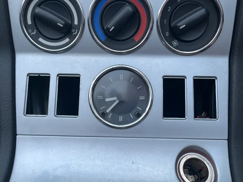

I’ve pushed the 4 switches out from behind but I cant see how the clock comes out? At the moment I don’t have radio removal tool so if I need to remove the radio I’ll find some. It seems to me that’s the two screws holding the radio in but with a torch they don’t have a visible head so tried Allen keys and tiny Phillips head but nothing seems to bite
Can anyone confirm how the clock is removed please?

Held in with a couple of fairly standard size Phillips screws (only short in length)
You should be able to get to them by taking out the two screws in the side of the centre console trim by the clutch pedal and get your hand up that way. Fiddly but possible
