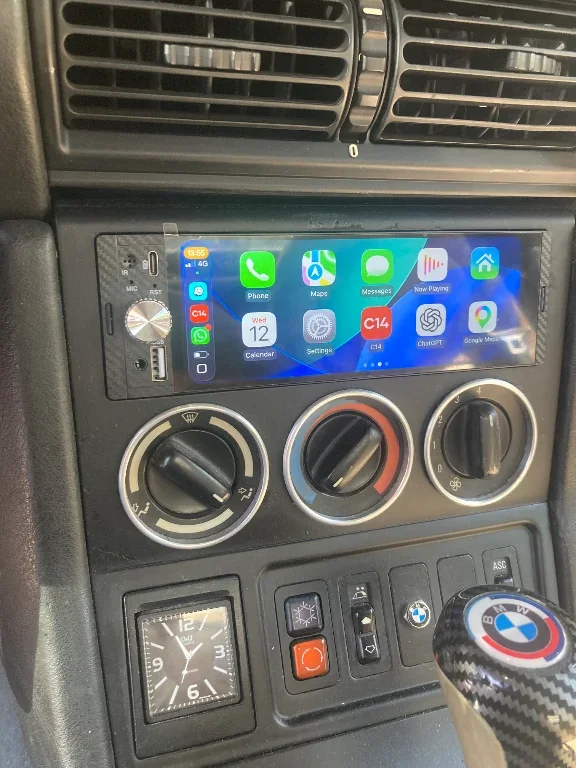

CarPlay or Android upgrade.
Safe and cheap.

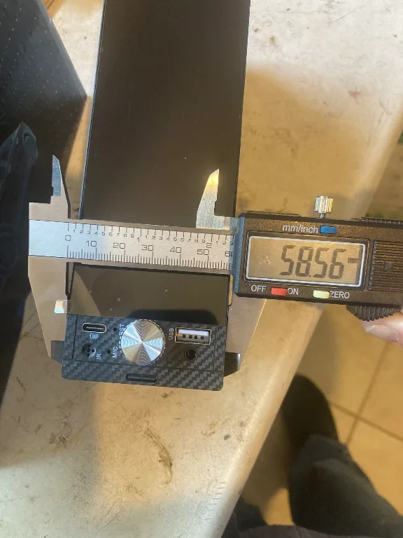

Serious error in the Ali Express ad - height of unit is only 58.5mm and not 62mm - so it fits into our 60mm opening.
Plug and play @ under £40

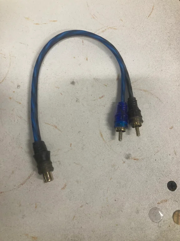

(You many need Y cable if you have an AMP)
