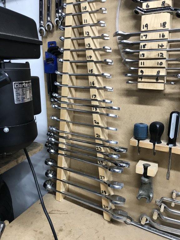

Couldn’t do much on the car, so sorted out some shelves that were bowing under the weight of all the Z3 stuff I have amassed:eek:
Thats the trouble using MDF shelves
But a couple of extra brackets…
And had to cut a few more slots to take the additional sizes of spanners acquired.
18, 22 and 24mm

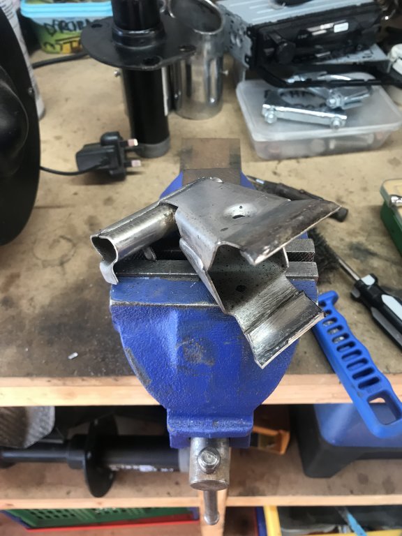

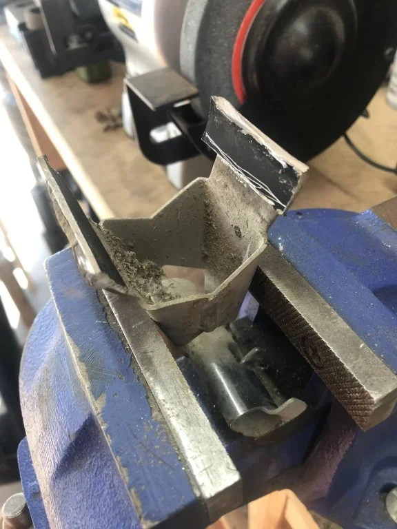

Next was the exhaust issue as the one I bought ( although really good value) didnt have the rear bracket on it…. So thanks to Andy (@spurs fan in a coupe) who provided me with the part I needed ( cutting it from an old exhaust)
next lose the surplus pipe..
then a clean up…
And a test fit….
Yep that will work … just need to call my welder in and thats one more issue resolved

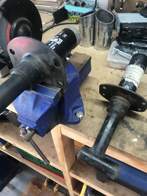

Next problem… front bumper mounts
Mine seized solid. So got a pair from Andy a few weeks ago…but like all of them the bumper height adjuster is seized up… so plan B…. Take the old pair and butcher them:whistle:
These are totally seized….
So a little introduction to my angle grinder..
And why it was seized up
Now just have to drill/ cut/ napalm the other inserts and retap the thread ( and yes I have a 27mm tap to clean it up) then a kilo of copper grease and it will
do what its supposed to =))=))=))
then a clean up…
And a test fit….
