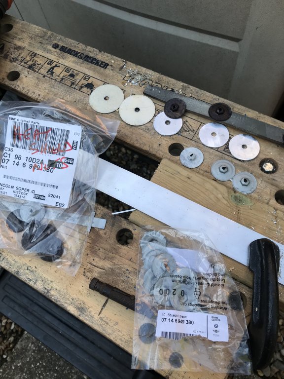

While underneath I realised I hadn't removed all the heat shields, and some of the fixings were rusty so sprayed and carefully removed them so the stud didnt snap off, and gave the lot a clean.
some have got over large holes so I will pick up some large Ali washers for when they go back. Got 10 new body nuts plus the better ones taken off, should be ok to reassemble them.

Then all the ali heat shields reinstalled with new body nuts and oversize washers
Ebay wanted £2.05 per disc, so bought a length of 40mm wide ali strip (2mm thick ) and made some with a 38mm hole saw.
Worked fine and all the heat shields back on.
I wonder where you got the idea from Malc:whistle:;)
