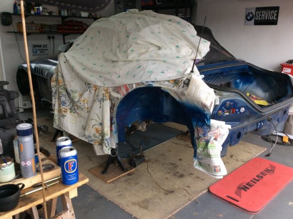

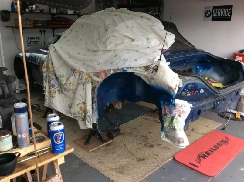

Masking , then zinc primer and Topaz Blue........

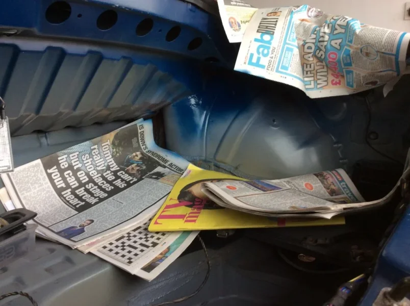

I did remember to put the roof up and mask off the holes so I didn’t spray the roof through the shock mounting holes!!
I also went over the repair in the boot
To be honest with all the Fosters....I wasn’t sure if I was spraying Topaz Blue paint or beer as the cans looked the same..
But seemed to turn out ok.

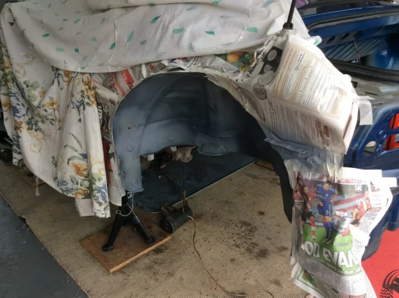

After the shock of having to pay so much import duty....carried on with the cleaning and prep work under the car.
I spent more time washing the underside this morning than I normally do cleaning the 1.9.... :whistle: sorry Andy !!

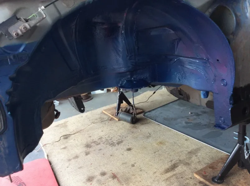

But then wire brushed and treated all the studs underneath....and while that was drying masked off the wheel arches as didnt want to ruin what I already had done.
A couple of coats of zinc oxide primer, then a grey stone chip. I was going to use RAL7002 which is a close match...but the price of it and ‘ its underneath anyway’ :whistle:
