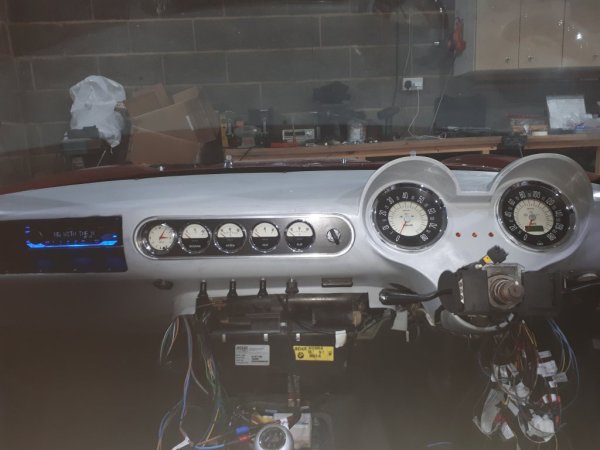

OK. And having wrestled with the angry snake - what did you do with it? I don't see your heater controls in any of your pictures?. . .
and the heater control wires are akin to wrestling with a very angry snake. Doing all this in 32c heat doesn't exactly help either!
Heater controls are below the centre gauge pod. Three 'choke knobs' on braided wire. All are push/pull. One for heat, one to adjust the internal flap for windscreen or footwell vents. The third is a dud in my case, as the amount of aggro to connect it to the other flap wasn't worth the negligible benefit.OK. And having wrestled with the angry snake - what did you do with it? I don't see your heater controls in any of your pictures?
There isn't a water flow valve, only air flow ducts. The water flows constantly through the heater matrix, but air only flows over the matrix and along the ducting when the appropriate setting is chosen.On a standard (ie non messed with zed) how is that water flow valve controlled? I expected it to be a pull/push cable that could partially open close the valve - but you called it a solonoid. So is it just fully open or fully closed? Is there a thermostat that opens/closes it based on the position of the blue-red knob.
So in your case it's always fully open and you avoid cooking in summer by simply closing the flaps?
The heater control valve allows coolant to flow into the heater matrix. It looks like this:There isn't a water flow valve, only air flow ducts. The water flows constantly through the heater matrix, but air only flows over the matrix and along the ducting when the appropriate setting is chosen.
Yep and turning the fan off!So in your case it's always fully open and you avoid cooking in summer by simply closing the flaps?
Yes, there is a microswitch which is made/broken by a small moulded part on the BMW heater control wheel.The heater control valve is controlled via an electrical switch on the temperature control dial, as shown in the schematic below:
Yes there is.There isn't a water flow valve,
I thought it was used for bleeding. You're right, though. The valve is opened when the temperature is switched away from cold (wiring diagram says "switched to maximum", but the microswitch is near the cold setting).Yes there is.![]()
