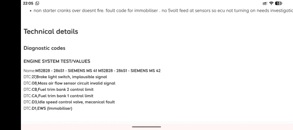

    stewartF replied to the thread Help please 🙏.
    Thanks, for helping 👍🏻 When I first got the car it broke down and came up with the airflow error. There were a couple of leaks in the...
  • colb
    colb replied to the thread Help please 🙏.
    Sounds like the EWS system has lost sync with the main DME computer and not releasing the starter to allow it to fire up. A good scanner...

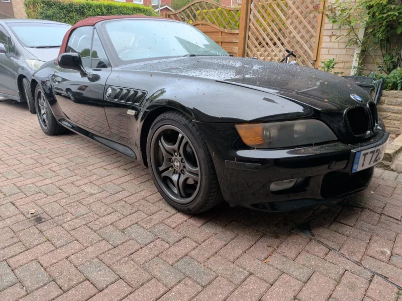

    Good morning, I have a 99 2.8 z3 I've recently changed the rocker cover, gaskets, spark plugs, air intake, brake pads disks and...

    stewartF posted the thread Hi in Introduce Yourself!.
    Thanks for letting me join, I have come in search of help as my z3 has decided it doesn't want to start. I'm Stewart, 45 live in...
