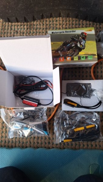

Dash cam hardwired..
Thank you for the reply. I don't understand Volts as what you can and can't use. I think my kit pictured has an inline converter so im...

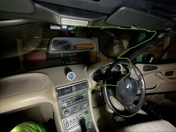

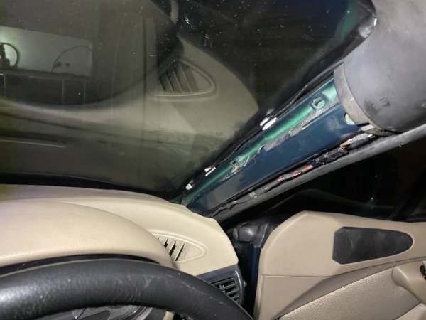

Here are some photos. The green line shows the wire path.

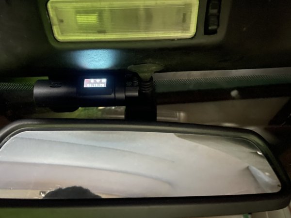

I recently hardwired a dash cam in. I put it as high as I could get it on the windscreen, in the centre near the mirror As for wiring...
