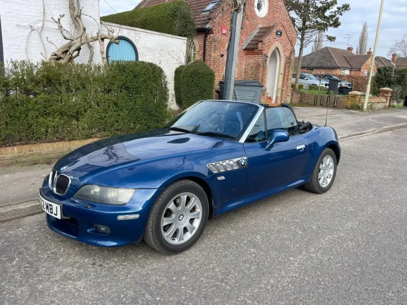

Hello everyone. I very recently bought this nice Z3 3.0i automatic, and I am looking to replace the auto transmission fluid. According to a source, I would need the FEBI BILSTEIN 1001357 Automatic transmission filter kit, but I am unsure about the oil. Can anyone recommend what type of oil is best? Is Dexron III OK? Or shall I go for something like a lifetime oil ETL 704SE? The car is in Hampshire, England. Thanks in advance.
