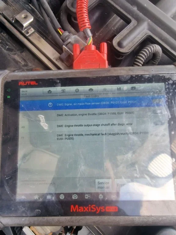

Mechanic did say he’d disconnected the exhaust so didn’t think it was broken cat (?)
Also changed the throttle body but hat appears not to have fixed anything.
This is a screenshot of the OBD codes.
