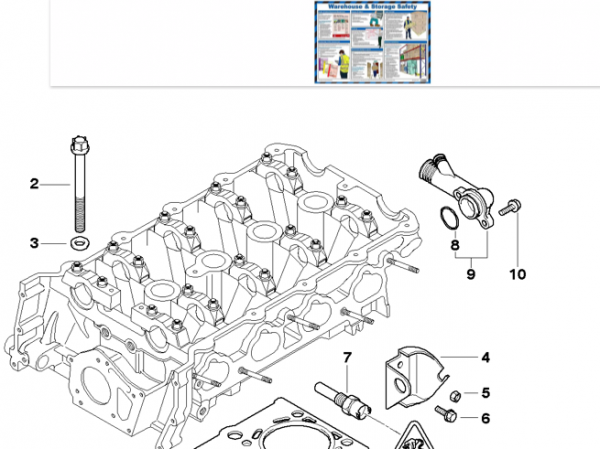

jonco
Dec 6, 2011
159
Chester
'98 1.9 Auto
hi Jonco,
yes, currently looking at the hoses to rail, think they have all seen better days, so its going to have to be a swift purchase of 5/16 vac hose me thinks
Sorry thought you meant cooling hoses and I meant parts 1&2 on first pic and 8&9 on second upload_2020-3-29_19-49-15.png
