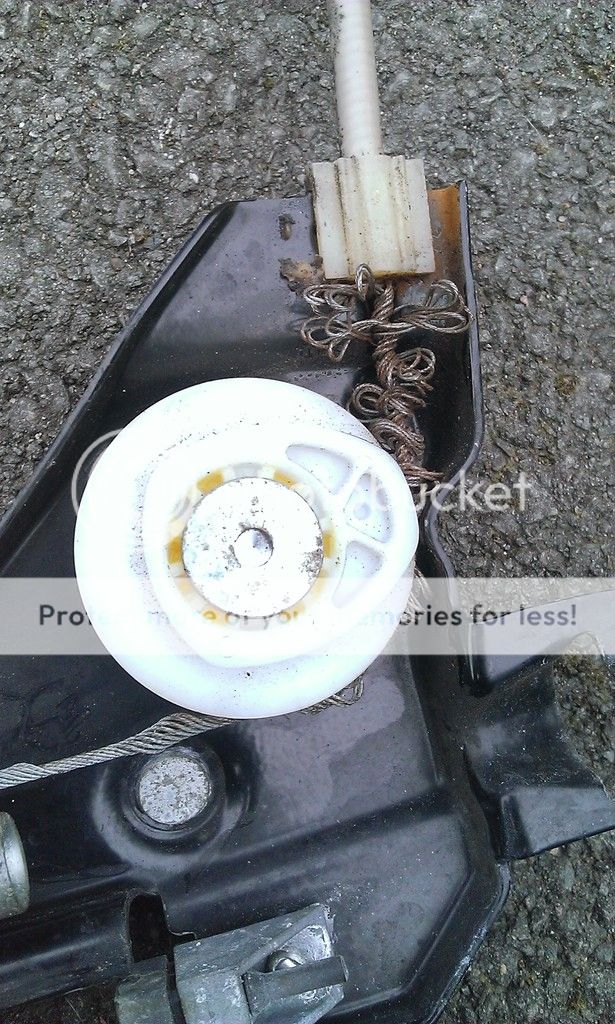

Our daughter has and audi TT and the electric window regulator has just packed in. The wires snag up and jam up. Seems to be a common problem and she had it on her previous one. What a pain in the neck to get it apart, it's taken me 1.5 hrs just to find my way in hidden fixings all over. Still got to get the old one out so looks as if i'll be busy on Saturday still saves £150 labour.

Changed the regulator this afternoon not too bad a job so daughter is happy again. This is the cause of the grinding noise when raising or lowering the window.
