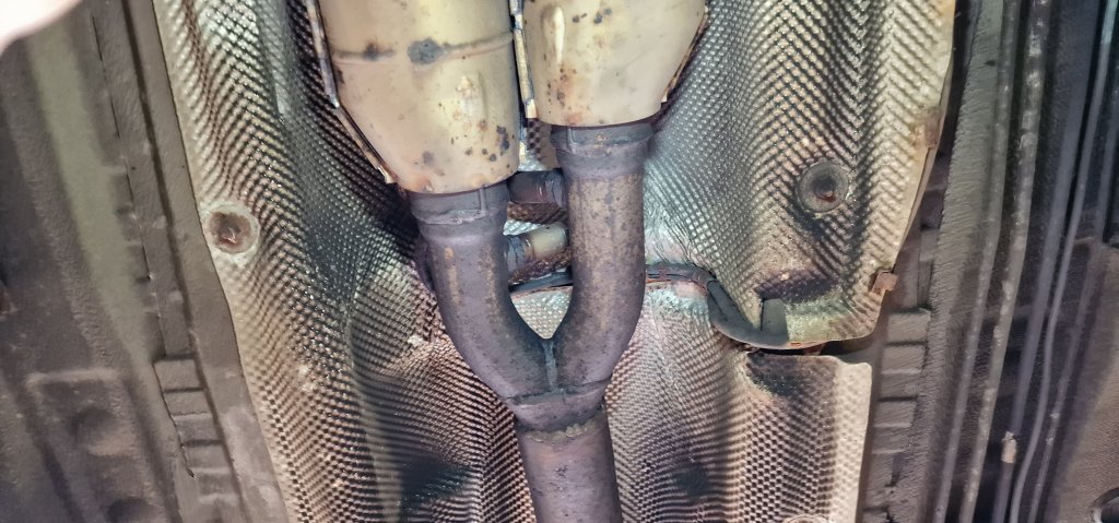

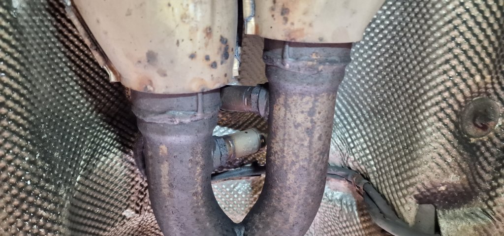

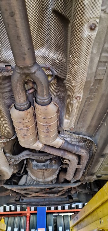

Your zed will have 4 lamda sensor
Bank 1 sensor 1 and 2 is cyl 1-3 pre and post cat sensor
Bank 2 sensor 1 and 2 is cyl 4-6 pre and post cat sensor.
Stephen.
Hope these may help front sensor awkward to see rears easier.
