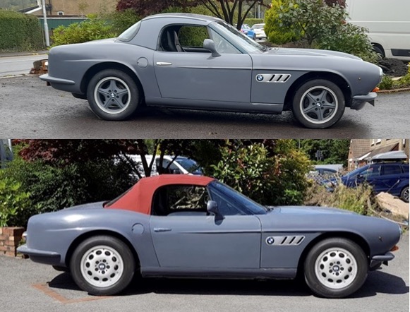

The reason for the ET34 is that I want to push the whole wheel out. Partly to better fill the wheel arches but also to move the tyre away from the strut. I want to fit a taller tyre to fill the gap all round but that brings the top of tyre close to the strut.
Lowering the car will reduce the gap at the top of the wheel arch but the gap in front and behind the tyre will still be humongous.
Top picture is what I've currently got. 16" wheels with 205/55
The bottom picture is a mock up. photo chop job. made to look like 17" with 205/60 This reduces the arch gap all round by around an inch and causes a 6.5% speed error because of the bigger rolling radius. But my speedo is >6% out anyway so will ctually be more accurate - and, I think, look better.

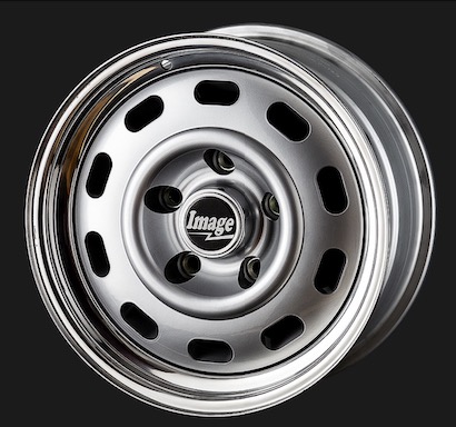

To the best of my knowledge only Image remain as a UK manufacturer. They’ll make them to pretty much any spec you like. They’re super helpful too.
Thank you IainP for that link to Imagewheels.
Anyone want to buy me a set of these - I won't say what they cost . . OK I will. +3K a set. Imagine if I bought them and kerb'd one I'd be in tears at the side of the road.
Finding a used set of steels and sending them to the bander is an idea though. But the X1 wheels is my 'plan B'
