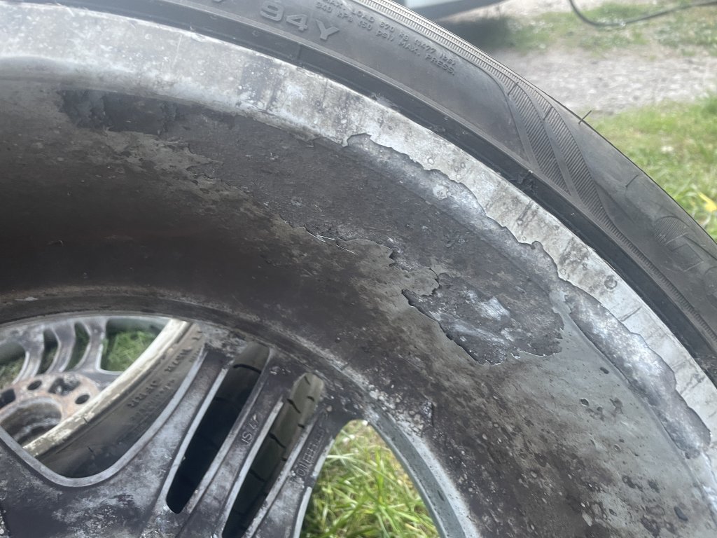

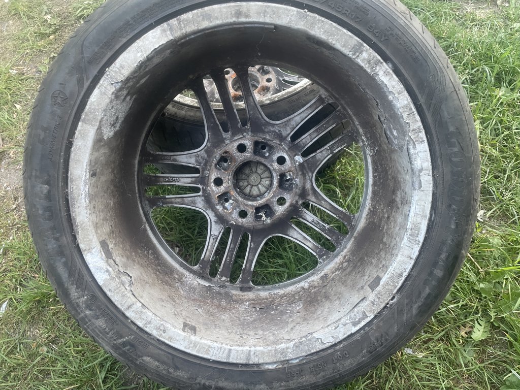

I bought some Style 89's this week and although the front sides are in pretty good condition, the backside are very much not (see photo)
All the paint on the inside is or has peeled off
What options do I have for improving the backs of these wheel?
Powdercoating, painting myself
I am not overly fussed about the back as long as they are somewhat silver and clean
Any advice would be much appreciated

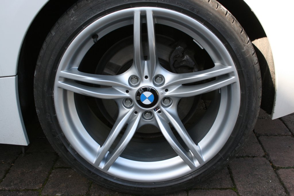

I did a full set of 326M wheels on one of our E89s. They were in a terrible state, with chunks ripped out them. I don't have a 'before' picture but this is how they turned out....

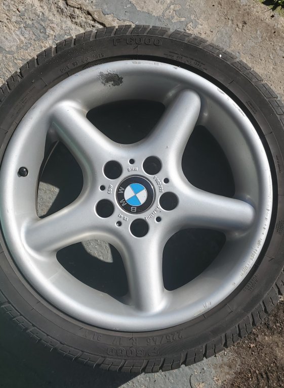

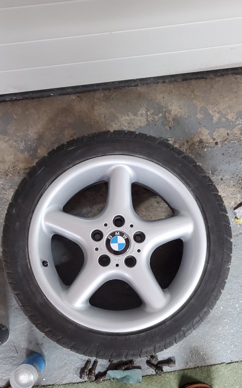

@bmwz3tower - Your refurb looks very good, the link works, thanks

I only did mine 2 months ago so can't really give a full assessment but they still look great now
