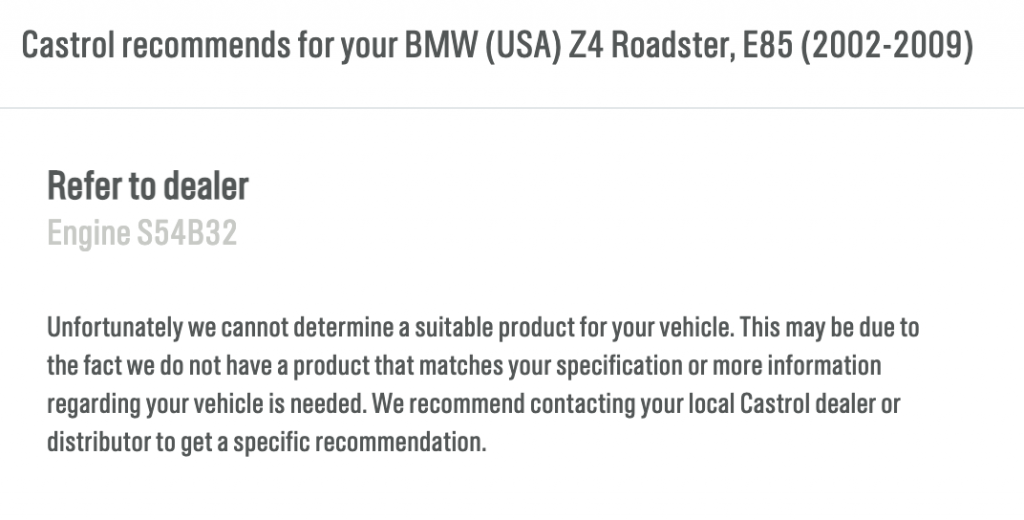

Yes, the owners manual says 5w 30 or 40, but the mechanic videos are mostly 10w-60 as is the Castrol Oil Selector web site. Seeking clarification from those wiser and more experienced than me.
