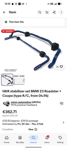

Strongly recommend these for the Z3, they do lean alot I would fit those bars with normal rubber bushes so you do still have a bit of give.
I used to track my Z3 with a set of HnR and they were brilliant.

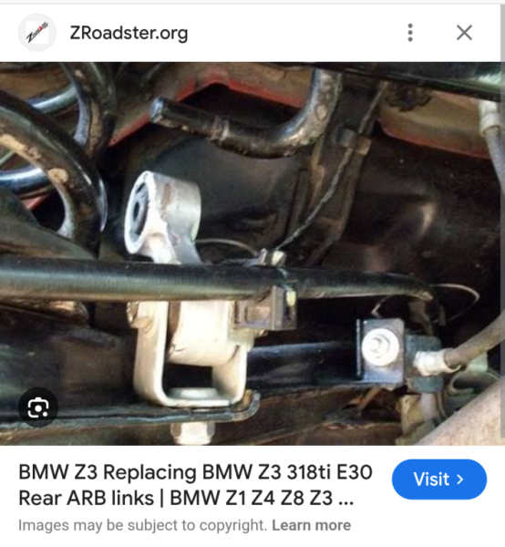

In terms of connecting the end of the aftermarket anti roll bar, how would you go about doing it? Because the OEM system is a pin into the bush, whereas the HnR anti roll bar has bolt holes.
I assume I would just put a bolt and nut through it?
The front is very simple as the drop links are bolt on, so you can fit the bar and then the new links/old links.
The rear is a whole different story, remove the spare wheel for extra room to feed the bar in, you'll need to fit the drop links to the bar first as its a right pain to fit them after with the bar in place.
