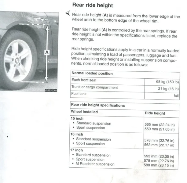

So, the previous owner lowered this Z3 but never retained any information about exactly what parts were used or how much it was actually lowered. But I know that it is too low. Going off the Bentley book, "normally loaded" on 17's the stock regular and sport ride height should be 660-675mm in the front and 578-593mm in the rear. Instead, I've got about 560-565 all the way around, and that's unloaded so the measurement would be even lower if I happened to have two sets of 68kg weights an another of 21kg to measure it properly (Seriously, BMW... wth?). So, by my admittedly dubious Oklahoma education system math, that's a >100-120mm drop from the Sport suspension, right? That's a lot.

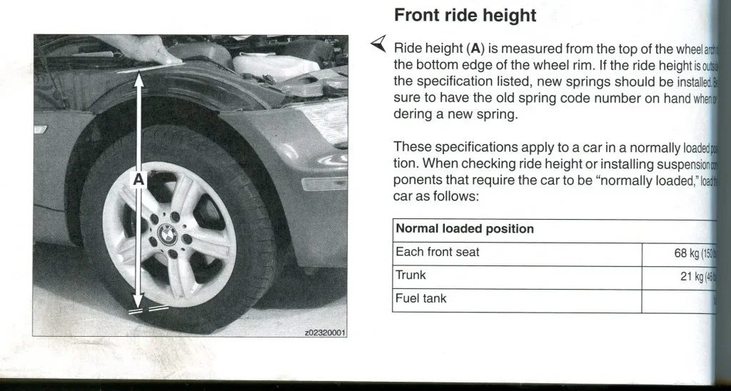

Your measurement at the rear of around 561mm seem about right for 32mm lowering springs. Your measurement at the front should be around 637mm with 38mm lowering springs. Not exact because the BMW height specification is for a loaded vehicle.
Are you sure you are measuring the front height correctly? - from bottom edge of wheel rim to the top of the wheel arch (the black plastic liner).

100mm (4 inches) is huge and will be clearly noticeable - the car wouldn't sit dead level at all and the wheels would likely hit the bodywork when you turned a corner.
Attached is how you should be measuring the front.
I have sport suspension which is 15mm lower than standard and even so I have to be VERY careful going over speed humps to avoid grinding the underneath.
If ground clearance is an issue for you, suggest swapping your H&R lowering springs for standard ones.

WTH? I'm measuring from the top of the actual wheel arch, but that is not how I would describe that photo. And, if that somehow is the right way to measure... How the hell do you measure that in the rear? Now I'm even more confused.
Also, there is visible damage to the inner guards up front from being so low. So, yeah, it's low.

Of all the asinine things I've learned about this car since I bought it, this is... among them. I'll re-measure when I get home. Pretty sure it's still going to be pretty low.
So, measuring by the method illustrated in the photo... which I contend has to be high on the list of Stupidest Ways to Measure Ride Height and directly contradicts the text description of method in the Bentley manual and possibly that of the book the scan was taken from (can't tell for sure, it's incomplete), the unloaded ride height in the front is currently ~645mm (25 3/8in). I was able to find about 150lbs of crap to load in the driver's seat, but not enough for the rest, but the difference at the front-left was only ~4-5mm. If that's accurate, and it might be since now it's within the realm of reason, then I'm only actually down about 30mm from standard and roughly on target for what you expected.
So, I guess I need to get standard height springs. Which leads to the next question... which springs are those? Apparently there are 3 part numbers to choose from and I can't find any specifications for any of the three, or specifications for the aftermarket springs intended to replace any of the three part numbers.
