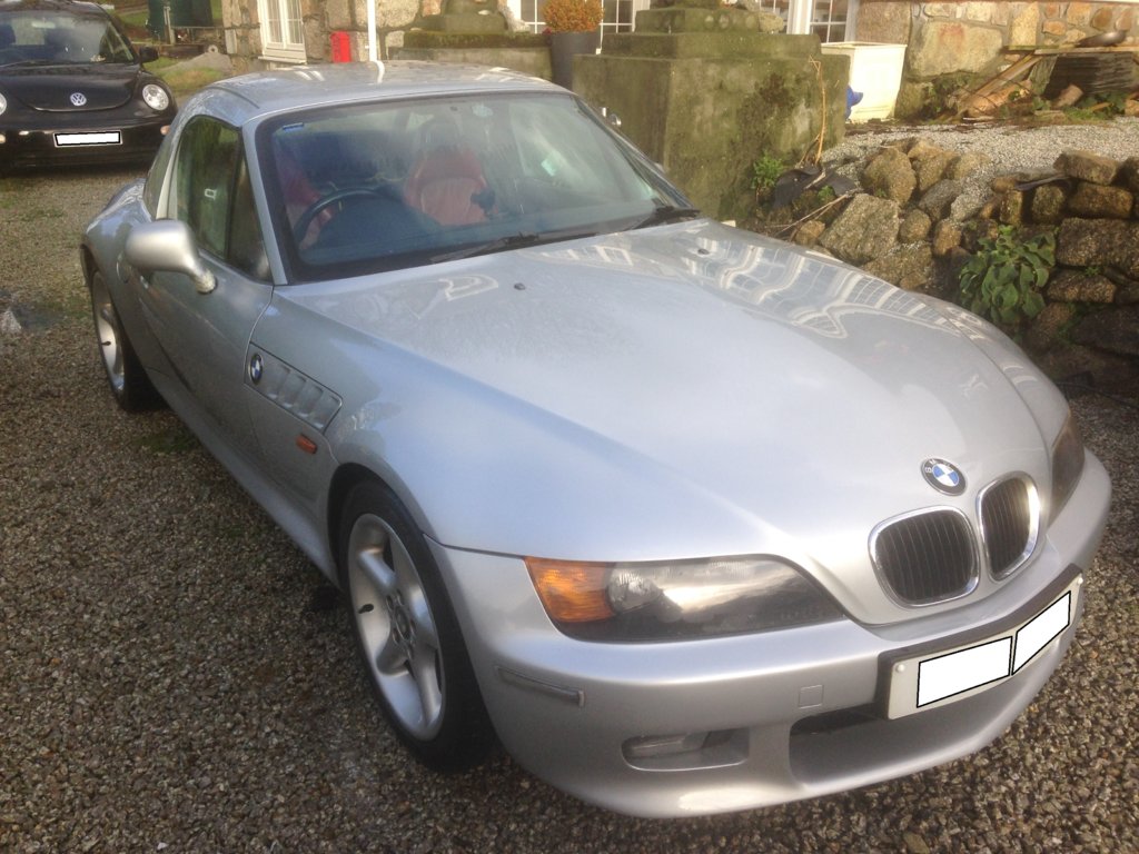

Earlier someone expressed that it would be good to post my findings with regards to having a 20 year old Z. And the options I have made with regards ideas of Selling and getting a better one or working on mine and upgrading.
It always comes down to condition and economics. And what you would pay for a replacement Z.
The first thing was to look at the condition of my chassis. Mine is a 2.8 wide body in silver with 140K on the engine. Now the engine we all know is reasonably bullet proof but its at 140K so............. upgrade/new engine.
So any Engine work/replacement I knew I needed to looked carefully at her body so it would not let me down with any money spent.
When I looked at the economics I would get 3+K for her now (with all the wear and tear) and then I would have to spend 5-6k on a replacement car, in a condition I would want. I have owned her since 2008 which is nearly ten years and she has been a great little touring runabout. So she owed me nothing and maybe I owed her a little TLC...
All I can say is that stripping down your z down to her Knickers is really easy, if you plan properly.

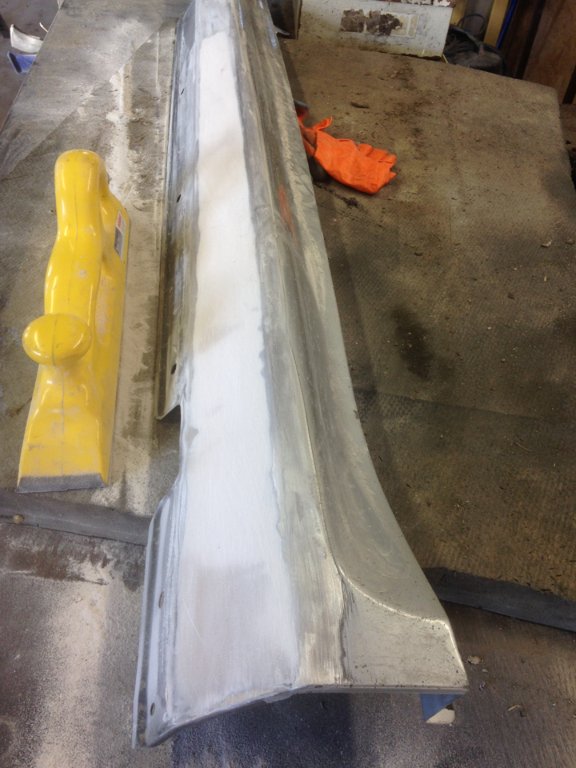

The sills are off and surprisingly despite never having been internally wax oiled she is in good nick. The wax you see is the original wax protective dip.
I noticed though that the small side panels are prone to mud ingestion so they need a thorough cleanout and re-sealing. I shall use Sika flex or similar before fitting them back. The Area you have to do this in is around the internal stiffening panel strut. It collects mud from the rear wheel kicking up (even with the mud guards in place)...
This is the only are that seemed to have a panel that needed replacing. The rear drivers side quarter panel. The rest of it was restorable or if great nick just needing a clean.
Underneath the rear quarter panel, it was really bad on the return sill. When I cleaned it all off the sill on the panel was nothing but holes. It was time to replace if I want that 5K miles look.

The other thing amongst all this wondrous planning I did... Was to forget to check the replacement sill condition. Sills was one other area I knew I should replace. They are Cheap and I bought them as "BRAND NEW" off of Ebay......I cursory looked at them when they arrived, they were right.
Only when I took the old sill off and compared both together did I find that one of them had been damaged in transit. So sadly that meant extra work a bit of panel beating and some filling to repair it. Its still a new sill, but this was annoying

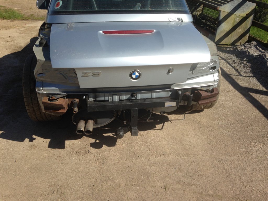

I fitted a Towbar from Watling
This is a great kit, took 2 hours to fit (follow the instructions explicitly). No "Cut out" to the bumper and standard electrical connecting so no relay required. When the bumper is on all you see (if you look for it, is the Square removable socket and electrical socket. She will now tow up to 1/2 tonne (no more) on a removable hitch and you loose no ground clearance. So a camping trailer, Jetski or Glider is ok. Overall you do not exceed 500Kgs

View attachment 52636 The sills are off and surprisingly despite never having been internally wax oiled she is in good nick. The wax you see is the original wax protective dip.View attachment 52638 I noticed though that the small side panels are prone to mud ingestion so they need a thorough cleanout and re-sealing. I shall use Sika flex or similar before fitting them back. The Area you have to do this in is around the internal stiffening panel strut. It collects mud from the rear wheel kicking up (even with the mud guards in place)...View attachment 52637This is the only are that seemed to have a panel that needed replacing. The rear drivers side quarter panel. The rest of it was restorable or if great nick just needing a clean.
One interesting thing is for the rear quarter panel removal is you need two people. Someone should hold the boot lid. Because you have to remove the boot hinges and support it. This is simply because the boot lid is attached to the rear quarter panels. The good thing though is once the panels are off you can just put the lid back because the boot catch will hold it in place. DO tape it on as well though.... see towbar pic.
