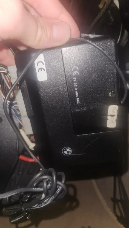

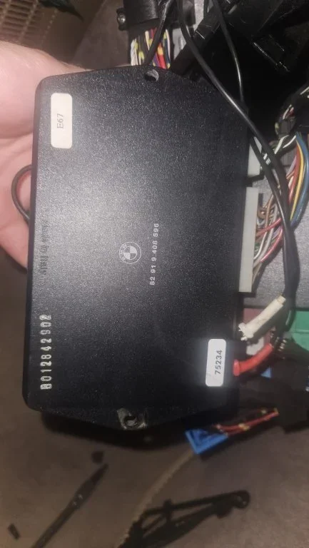

Can you take a pic of your alarm module, it would be helpful if any part numbers on there as well to try and pencil it down for you.
Hi, sure. Part number is: 82919408596. There's one well priced at £45 on ebay currently that matches. If youre able to help me work out which key should be paring with this module it'd be much appreciated.

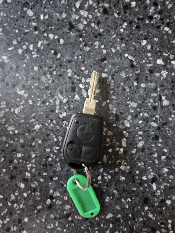

I can see that there is 5 keys synced to the module from my diagnostic so a chance thks key is not an original.

From memory that unit looks similar to mine which I have the separate brick remote and my key has no remote functions only a light.
The part number you gave only shows for series 3,5,7 in Realoem. For mine Realoem gave part numbe 82919404777. Hopefully the remote you have ordered will work with your suspicion.

Fault 3 – Wrong Remote Key
I discovered that my car was fitted with the older BMW alarm system that uses the separate "brick" style remote fob.
For years I had been trying to sync a later BMW 3-button key which is used on later Z3s and other BMW models.
The key was never going to sync because it was the wrong system.
One of the clues was that I could put the alarm module into learn mode, but neither my original key nor a replacement 3-button key would pair with it.
