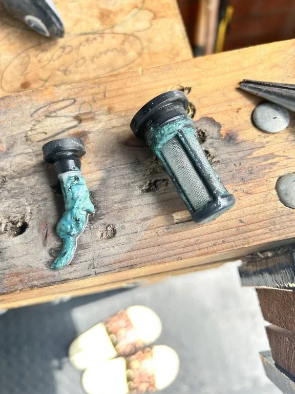

Alright, going to answer my own question. That didn't take long at all. Found a post on another forum and set to work. In under an hour I managed to:
  • Remove the bottle from the car.
  • Remove the severely gunked up filters
  • Clean out the bottle (as best I could)
  • Replace the now spotless filters
  • Replace the bottle in the car
The jets work like a dream now, I think, certainly a lot better than before. See pics below. All feedback welcomed.
Before:
Filters and the inside of the bottle
After:
Wasn't able to get to all of the grime but I'll probably use another method next time, maybe agitate it with ball bearings or something.
The end result (please do let me know if this is how it should be)

That buildup was grim. I literary had blow through the small filter and then scrub the remnants out of the plastic with a toothbrush.
Seems like this is going to need to go on a list of jobs to do every few months.

Most likely because at some stage, someone has not been putting washer fluid in it. Here in the tropics thats a bad idea. plain water goes off moldy black sludge eventually clogs everything up.

Pop some Milton tablets or liquid in the bottle, that will soon clean it up. A few cycles in the dishwasher also works as long as your better half doesn’t catch you.

That’s all well and good Tony but how did your filters not get gunked up? Spraying water in the top will do a job of cleaning the sides but all the grime must go towards the bottom of the tank surely?
It swirls around and washes out the top. I had my Z3 for 6 years,and only cleaned the filters once. A ten minute job at best.

Put all the bits in a bucket and give an overnight soak in a solution made up of dish washer tab (or two)..... did the same job last winter and the job's a good one!

Dishwasher tablet in the tank or Sterident Denture tablets work well to clean the inside, just leave it to soak then empty and rinse out. Putting the whole thing in the dishwasher works wonders for the outside. Make sure the trouble and strife is out before you use the dishwasher.

The gunk and sludge forms from mixing different screen-wash brands. Different formulas and ingredients can react and cause slime to form, eventually clogging the filters. Ever since I learned that, I strictly stick to the same brand and after cleaning out the bottles in my Z3 and 5-Series, I have never had any more problems with the filters getting gunked up.
