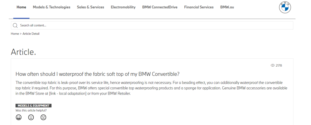

Feb 18, 2016
Z3M Imola and Z4 (e89)
Adding a repellent won't make your roof waterproof, the membrane does that. If its leaking through the material then the membrane is holed. There is the argument the cleaning and then adding a repellent will keep it cleaner longer, who knows. I suspect most people do it for an aesthetical reason, but there is no maintenance reason for adding it.
