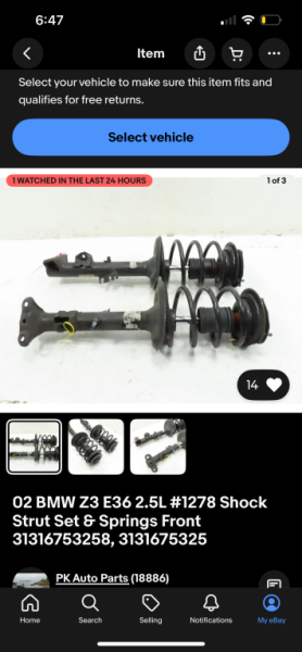

Sorry for the spamming of these forums with random topics gents, as is with a big project like this I run into random questions and issues, context I put a 350sbc into my z3 and have slight front sag issues
first photo from a bit ago when on stock rears
Currently with the Hoosiers
they don’t necessarily need to be track oriented or even a whole set the primary goal weather through weight rating or height would be just to lower the front maybe an inch or so?

The front end is fully e36, so front coilovers from any model fit straight on a Z3 .
The springs should vary from 4/6 cyl, in reality only the expensive ones have different rates from model to model.
If fitting used ones, wind down the collar fully, remove the spring and make sure the strut still has damping in both directions. Wire brush the threads and use a silicone, or ptfe spray, they dry without being sticky, stops dust collecting and clogging the threads.
If you want to adjust the camber cheaply, add hard washers and use slightly longer bolts in the lower mount. Just don’t add that many you lose engagement of the locating nipple.
Probably a good idea to fit reinforcing plates, they’re easily available both new and s/h, they’ll gain you 3mm, 1/8” on their own.

Thank you for this I was under the impression they were from an e30 for some odd reason

Probably gonna order these now any thoughts on if I should change the springs and if so any reccomendations it’s from a 6 cyl model
