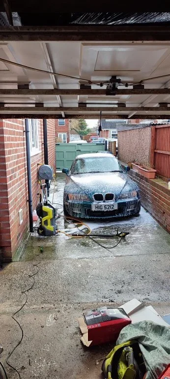

Well then...
This was 9 years ago, I was just a kid at 20 when I got this car. I've still got her, since then I've bought a house and since buying the house I'm sad to say, she has been in my garage as I lacked the funds to maintain her and petrol was killing me. Not been turned over In 3 years.. However.
My father, for my 30th birthday has offered to get her back on the road. Amazing news!
I have agreed with "modern classics" in Lytham, Lancashire that they will do the work that is necessary of the 1998 Boston green 2.8 BMW Z3. They do fantastic work, my partner's dad works with them as he has a body shop in warton and does bodywork for them regularly.
I plan on making her reliable and my daily driver. I have since changed jobs and only live 10 mins from work... The work that needs to be done is as followed:
Caliper refurbished all round...
Fuel tank straps replaced. Thanks malc
Exhaust changed to original. I was a yobo and had straight piped her. Sounds amazing but I now hate people with loud exhausts 😅
Diff spot welds checked....If they need doing I'll sort it with my partner's dad no doubt. He's a panel beater by trade and does amazing things fabricating metal "stuff" , I'll hold the light for him and pass the hammer 😁
I've just bought a set of Goodyear eagle F1 tyres
The gear stick spring has gone and when in neutral sits to the right. So that needs sorting. I think it's quite a big job if I recall correctly. ( I think that's the issue anyway)
Soft top needs replacing.... In my youth I did try to seal the rear window with black sealant and anew window. But it's knackered, perished and needs replacing. Once the mechanics are sorted I'll drive her to that bloke in (I think Swansea)and sort it.
She also had a little bit of a rough idle. I think this was something I did whilst messing around under the bonnet. I'm sure they will trouble shoot it...
Maybe install new struts, the ones that are in are rubbish. I she's got eibach springs so sits nicely. But the dampening used to make a weird noise.
There also just going to go through the car and make sure she's sound. Replace fluids and filters ect....
I did do a lot of work in the past on her, as followed:
Alot of polybushes.
Refurbished steering rack, new wishbones,
Had a new diff.
All new break lines.
New sills and I replaced the jack points on the chassis and welded them in.
New sill panels
New front quarters
Stripped and sprayed rear quarters
Stripped and sprayed hartop
Also stripped and undersealed alot of her
I'm nearly 30 now and the thought of working on her on the drive way hurts my back... Call me a snowflake, I dare you 😅
That's it I guess, maybe noone will read this, but it's at least documenting the history of this little Z3 that was once my partner's late grandfathers future project that he never got the opportunity to start.
I'll post some pictures once she's up and running.
Cheers, Pete
