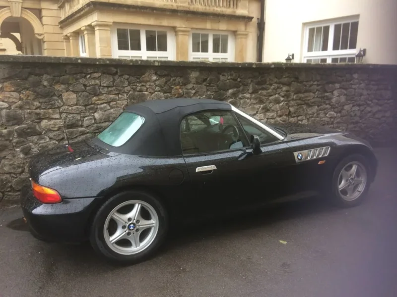

Hi all I’ve just bought a 1999 1.9 z3 generally good condition but needs a new roof so a trip to Swansea on the cards , also the central locking is not working you can only open drivers door with key & the boot only opens with key the passenger door only opens from inside. Any help much appreciated .
