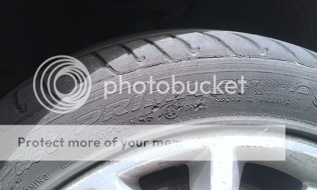

Mot or not ,what do you think Tony

One of my jobs today took me to one of the not so good areas of Leicester (Yes there are some!!!) and whislt having coffee break I noticed this on the car parked next to me so what would your opinion be @t-tony .
I did get the date stamp and will let you guess first.
Both very common issues with Michelin tyres the perished sidewall looks worse than it is but if any area exposed cords I would fail it. The worse issue is the treads "lifting and separating " and I would fail that. The sidewall is through scuffing alone the kerb. The tread is the tyre coming to pieces.

I was just reading the print on the side of the tyre which Brian photographed and it mentions under inflation. By far more tyres are ruined by this than over inflation. Over inflation takes out the centre of the tread first, but, under inflation allows the tyre to "roll" under itself, which not only allows the edge of the tyre to scuff against the road surface as you corner but also tears the tread as in the picture that Brian posted.
