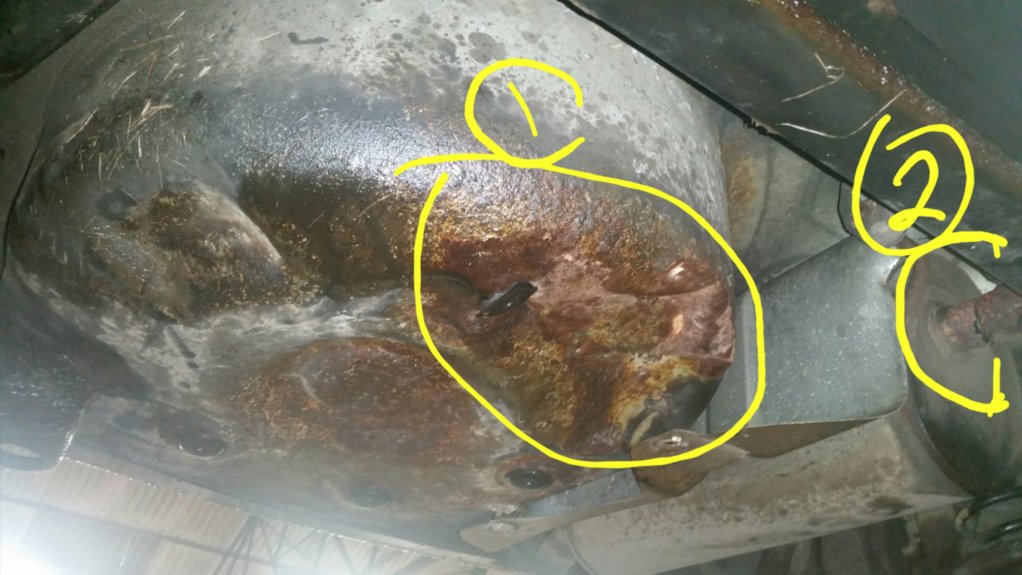

1. Spare wheel carrier has bit of a ding in it
2. Rear exhaust cracked open at backbox

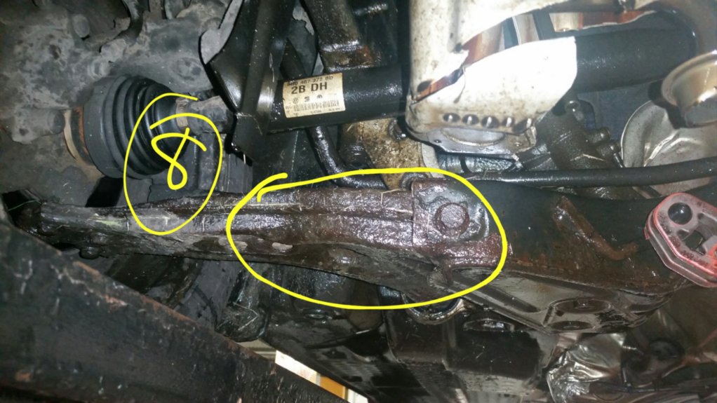

8. Not so easy to see but suspension arm and subframe both bent

I've highlighted stuff just to make easier to see start from rear of car
