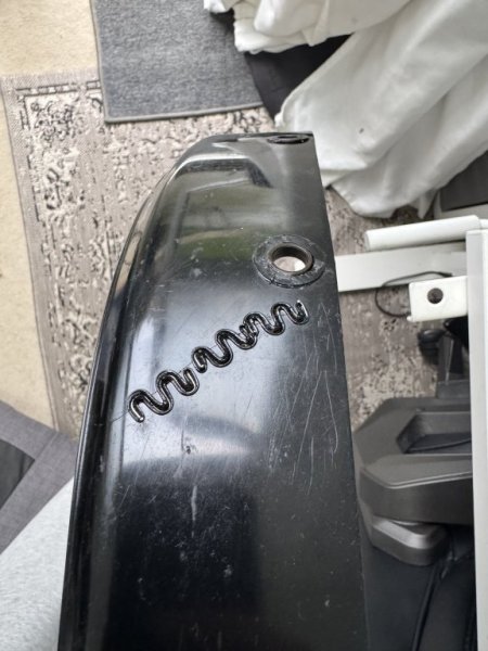

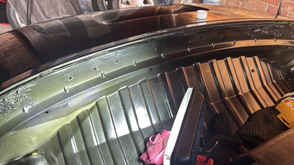

After a bit of investigation and pulling out the carpets, it turns out my leak is coming from the sealing frame (No. 13 in the diagram below – 51718398104). The water is either getting in through the frame itself, which is cracked, or finding its way past the perished/dripping butyl that seals the frame to the bodywork and roof.
From what I’ve seen, this seems to be a fairly common point of failure on the Z3, particularly where the frame itself snaps. In my case, it’s cracked in one place only, fortunately right down the middle.

I just wanted to update the forum and let people know what I’m up to. I’ll be cleaning all the old butyl off tomorrow. It definitely looks like someone’s attempted a repair before and done a not-so-brilliant job.
Before I refit everything, I was wondering if anyone has any tips or recommendations for reinforcing the plastic frame to prevent it cracking again?
