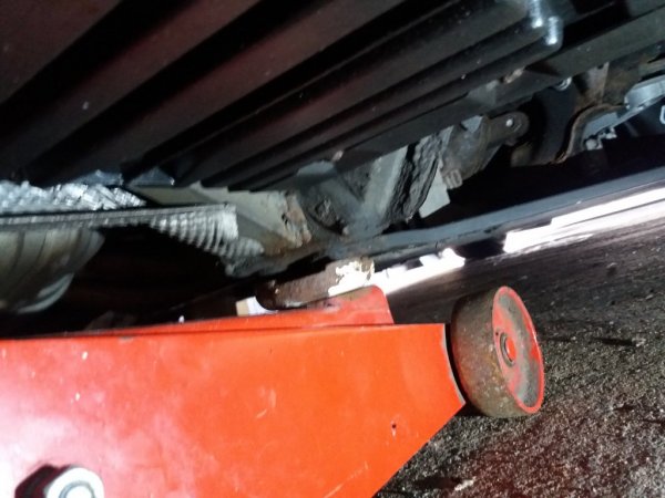

3. At the rear on a Z4 there are 2 stiffener bars which mount at the centre rear of the floor, this is where to jack up the car (DO NOT JACK ON THE BARS)

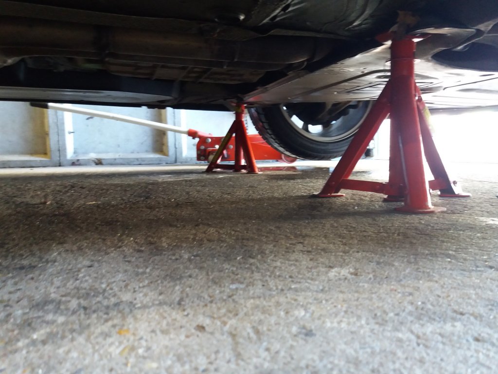

When you're high enough place stands under the jacking pads on the sills and lower the car onto them.
Lower and remove the jack. Rear end is done.

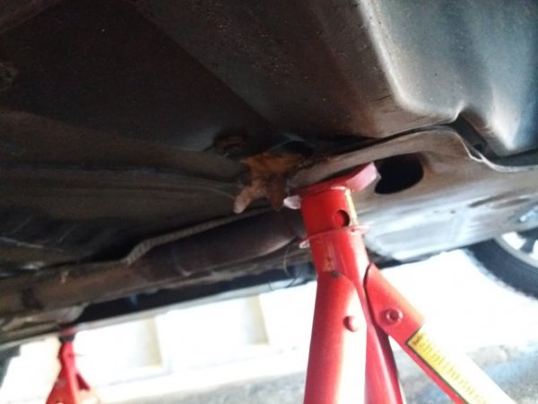

4. Move the jack to the front and jack up on the jacking pad on the sill. While doing this the rear may lift off the axle stand, this is normal and nothing to worry about.
Place an axle stand under the end of the alloy cross brace (use a flat stand or a piece of wood)
When you lower the jack the rear end will sit back down on the axle stand.

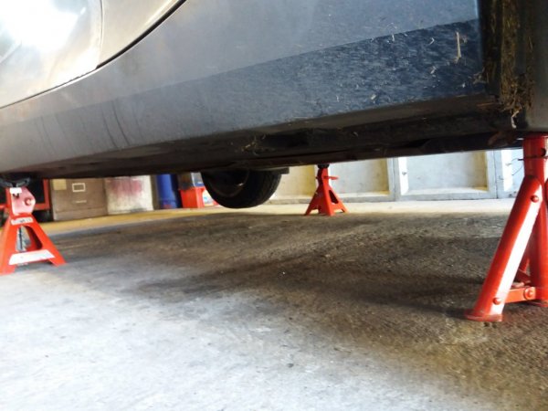

At the other side front repeat the same actions and remove the jack. Then you have the car sitting on 4 axle stands and you can remove the wheels.
