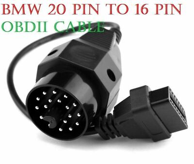

You may well need one of these, too.
One of these, plus a five pound OBD to USB cable, plus a free Windows 10 download of BMW INPA (can find it on this forum) is my solution
