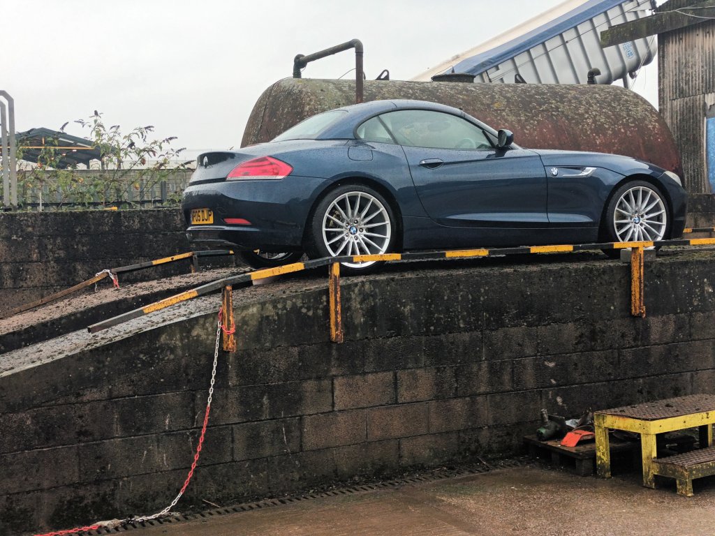

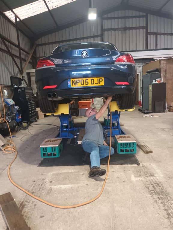

@TaffDaddy and me decided to have a bit of a pre-winter clean-up and underbody protection (hopefully) with Lanoguard. Having seen a few others on here use it we'd thought we would give it a go. Firstly up on the wash down ramps for a bit of steam cleaning, wet old job that one but effective, and then into the shed for a dry off with the air line and space heater, a few coffees and a natter then David went for it with the spray pot. To be fair it was very easy applying as its a very thin liquid so you can get it just about anywhere.

Did you remove the inner wheel arch linings to get in there ..or did you do something else..or not bother ?
Feb 18, 2016
Z3M Imola and Z4 (e89)
Nope just the metal bits open to the elements this is very much a trial, let's see if it lasts, being a lifetime waxoyl user this is unchartered territory for me. Proof will be in the pudding, if it lasts the M will get a full coating.

Thnx got a pot of it myself..looking to treat the Zed this winter hence my question 👌

I use it on my Land Rover mainly but isnt a one time only fix - only lasts 12-18months. Then needs topping up which is easy to do and I like it as doesnt take long and good to see whats going on being translucent. its a wax jacket really but as long as your aware of its life span. The trouble with waxoyl is its messy, it cracks and lets moisture in so corrosion can be hidden completely unknown.
