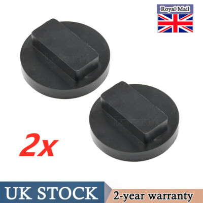

What do you guys use to make your axle stands fit better into the provided jack support pockets, ?. I'm just trying to avoid damage to myself or my Z..;)

No, the provided jack point pockets, the plastic ones on the bottom of the sill. The heads on all my stands do not fit well. I was thinking along the lines of a rubber puck or something, and wondered if anyone here had any other creative solution. ;)

@colb made his own from pucks I believe

I did use Ice Hocky Rubber Pucks as @bombur mentioned, sourced from ebay and then cut down with a hacksaw to make the rectangle shape on the top half to insert in the plastic jacking point recess so the larger bottom half provides a bigger surface for jacking against with a trolly jack or putting an axle stand under the car.

@ExMX5owner
You need something like this ( others available this was just for show purposes.)
Stephen.
These are very cheap. I can't understand why anyone would spend time and money making one. :banghead:
Because I can, why spend more than you have to besides enjoy making things as well as working on my Z's

Perfect, thankyou gents. :thumbsup:
