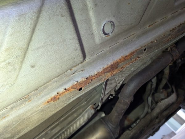

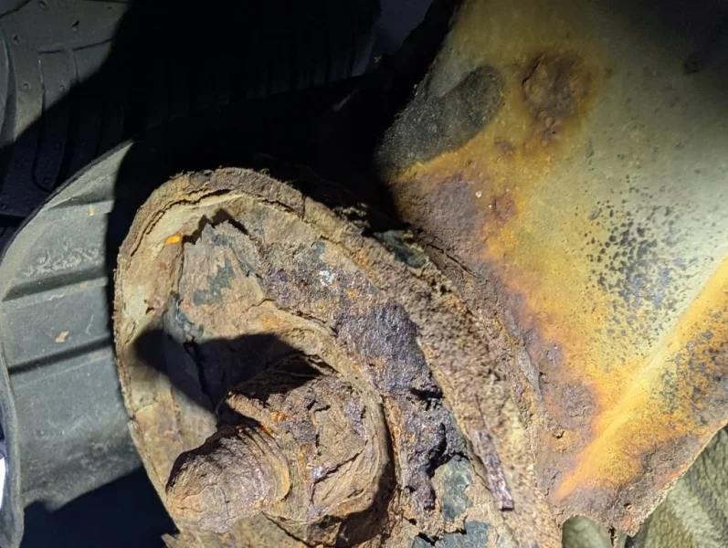

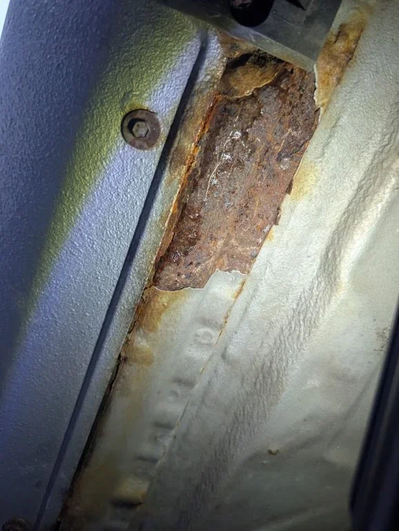

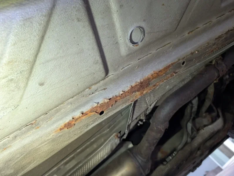

I included the typical rust and the one place that has scary rust.
That doesn’t look to be too bad. It looks like the rust has only attacked where the outer protection covering has been compromised. Localised clean, treatment and protection may be all that’s needed there.
That bracket never had good corrosion protection but, at least with the right tools and prayers, it is replaceable. A wire brush to get rid of the loose stuff will show the real state of it.
