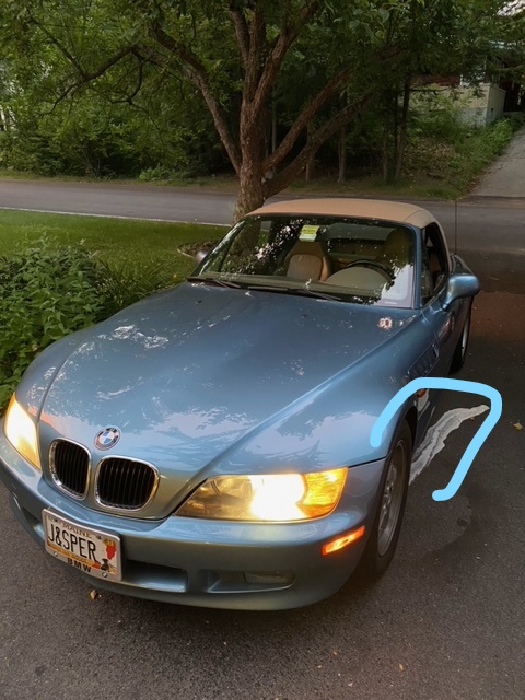

Overheated after long drive when arriving in driveway - Lost fluid, refilled when cool. There is probably a leak somewhere, searching that out.
  1. Coolant was blowing out through the expansion tank cap, not a huge amount. Possible cap not holding pressure?
  2. Found remnants of mouse nest in Intake Duct, probably didn't help the situation.
  3. Checked front Aux fan, turns on with A/C switch. Relay slot for high speed fan is empty.
  4. Have spare radiator switch but can't seem to find if that only triggers the A/C or the Clutch fan.
  5. Clutch Fan spins at engine speeds but doesn't appear to ramp up when temp gauge gets above 3/4 when idling.
  6. Not sure how to check clutch fan, was thinking there might be a relay but nothing in any of the fuse box diagrams. Not sure if the elusive #48 is it. Seems to be A/C related and not engine cooling.
Perhaps water pump as well? Looking for ideas.
