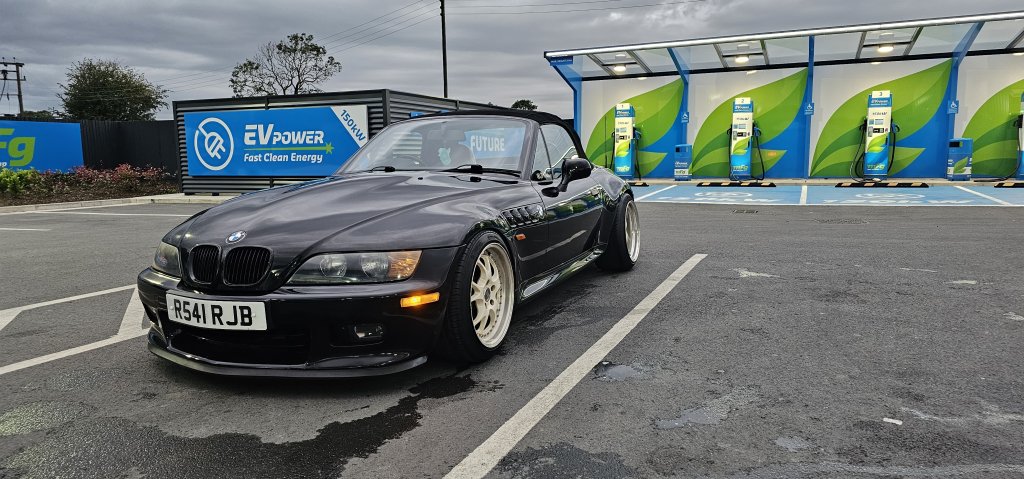

Hi ladies and gents! Im James, and this is the love of my life, my 1997 2.8 widebody manual Z3! Bought around 2.5 years ago now for 3000quid and lots has been done and changed since then! I wish I had started this thread sooner but ill do my best to try and recap and keep it updated going forwards! Ive lost a lot of the early photos of the car on an old phone that died and hadn't been backed up so this first post will be fairly text heavy but I did manage to find one photo from the Facebook market place advert that doesn't really show much!

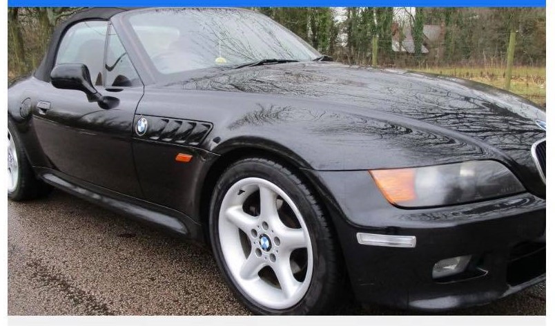

My second Z3 and it was bought completely original for 3000quid pretty much the cheapest running example for sale in the UK at the time in a half decent colour, good service history but the car was far from perfect! ill try and list the specs and the issues below;
2.8 manual in black, with black and red interior, pretty basic spec (no heated seats, no aircon, manual roof) 160k roughly on the clock but good service history, plenty of MOT, plenty of receipts and only a couple of previous owners.
Issues when purchased included;
Rotten sills, torn rear window, dash lights not working, gearbox detents worn, front shock blown, seat bushes gone, cracked front bumper and I'm sure there were a few other things but off the top of my head they were the main ones, however it was love at first sight and I drove it back home from Cheshire the same day!
I previously owned another 2.8 manual z3, this was broken for spares years ago but some bits I held onto, knowing I would have another at some point! so I got the car home on a Saturday morning and by Sunday afternoon I had replaced the suspension with a set of adjustable coilovers lying around from an old E36 3 series, a new rear window delivered by amazon prime, new seat bushings, I replaced the headlight switch with one from my old Z to fix the interior lights, gave it a very deep clean, fitted some orange 'us spec' led bulbs to my bumper markers and it looked a little bit like this...
Just in general a lot tidier and importantly watertight!

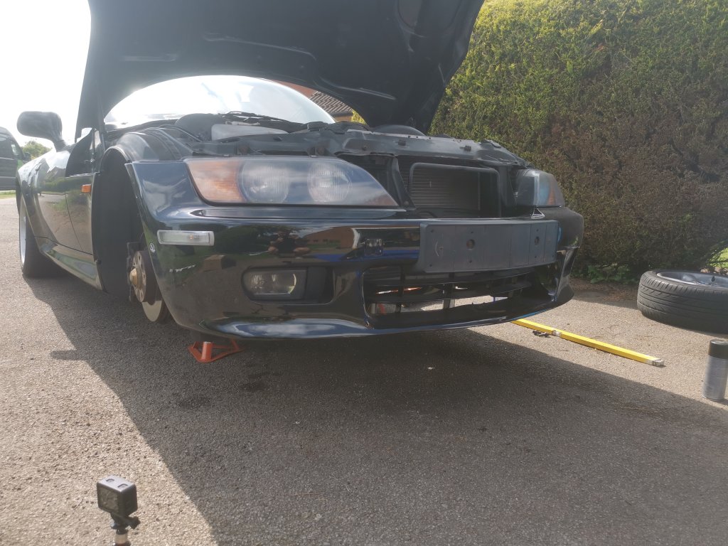

Next on the list of Jobs was replacing the front bumper, it had some deep scuffs and a large crack when I bought it, as if fate had planned it, I still had the front bumper from my old z, and the rear luckily...
As I drive a work van for most of the week my ex girlfriend used to use the car regularly, after originally thinking it was an old, terrible, silly and useless car she did actually come to love it! one evening she went to the gym, parked it up, went inside and the handbrake failed! The car rolled backwards down the car park and into a brand new Audi A6! 😅 Lets say the Audi came off worse but the Z had definitely looked better! the passenger rear had took the impact, it smashed the rear light, the rear bumper was cracked in half and the crash bar had taken quite a hit and pushed it back in, thankfully the rear arch and boot had not been touched and all the panel gaps remained perfect! we called the insurance and did all the necessary bits but made it very clear we didn't want to claim on the car and that we would sort it privately, I knew I could fix it myself for minimal cost! at this time the car was valued with the insurance at 5k so it would have been a good pay out and 2k in profit, but I just didn't want to see the car go! From the photos we sent them the insurance was adamant it would have been a total loss (shows how little they know haha)
To cut a long story short this meant that I now needed to replace the front and back bumpers, and the rear crash panel, and the rear light... guess what... I had all these parts. Sent my bumpers of to be professionally painted by a friend that works for an accident repair centre, I tied the front of the car to my garage and the back of the car to my range rover and pulled the lower rear panel back out, mounted up a new crash bar, new rear light and it was a near perfect fit, Job done! Again most of the photos of this I have lost but I've got a couple of the new bumpers being fitted and I did a YouTube video on the process! link in my signature if you want to see it.
That's the rear end after the repair, absolutely spot on! Strangely at least a month later the insurance company then decided to send out a loss adjuster to inspect the damage to the car... after it had already been repaired, he looked at it and had absolutely no idea why he was there and decided the car was obviously fine!

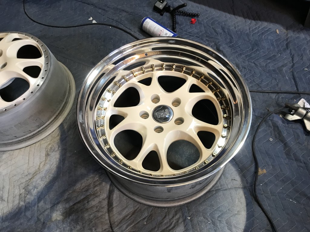

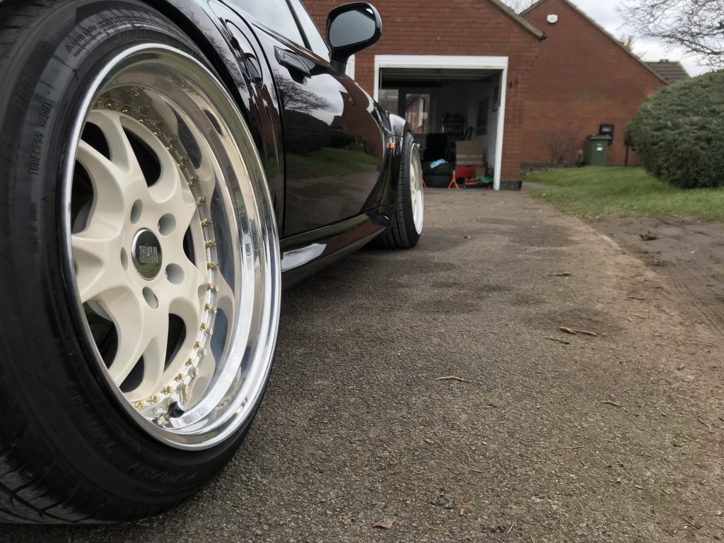

MOT passed and the car went away in the garage for the winter. Now that it wasn't being driven I took the opportunity to give the wheels an over hall! I had had these wheels about 10 years at this point in there factory configuration, 17 inches, 8.5j on the back and 8j on the front, I felt they fit the car well but I wanted to make them a bit more special and stand out, they had also gained a few curb marks in that time so needed a complete refresh! My plan was to switch the wider dished 8.5 rear wheels to the front and rebuild the other two with a much bigger dish, taking them out to 11.5 j wide!
I bought a pair of 3.75 inch outer lips and all of the replacement bolts for all 4 wheels in gold from SRR Hardware and set about the transformation! I stripped down and separated all the wheels, prepped the centres and sprayed them in 'ford ivory' which I believe is a colour mostly found on old ford sierras, Ive used it in the past and just like the sort of off while shade, just something a bit different, I also think it goes really well with the gold hardware and the tan interior. I gave my existing lips a wet sand and polish and fitted them and new the new lips back to the wheels with the new hardware, torqued up all the bolts to 26nm (144 bolts in total, fun task) and sealed them up with tiger seal!

I love how the wheels turned out and on the car they look incredible! the fitment was mostly just luck, I didn't measure anything, I just wanted some wide wheels and would work it out afterwards! I had to swap the adaptors around, put the 35mm on the fronts this time and the 20mm on the back and it just about works! the back is perfect for the look I want but the front is probably a little bit too aggressive, I'm planning to have the 35mm spacers machined down 10mm and the front should be spot on then! couple of artistic photos of how the wheels look on the car...

Very impressive work on the car!👍 Looks great, except I prefer the other wheels, think the replacements are a bit too much, but it's your car so.👍
Thank you! that's a fair comment about the wheels, they are pretty aggressive! I don't mind the originals and they still get used during the winter, but they just didn't fill the rear arches out at all

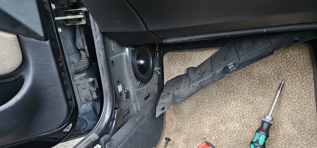

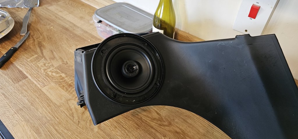

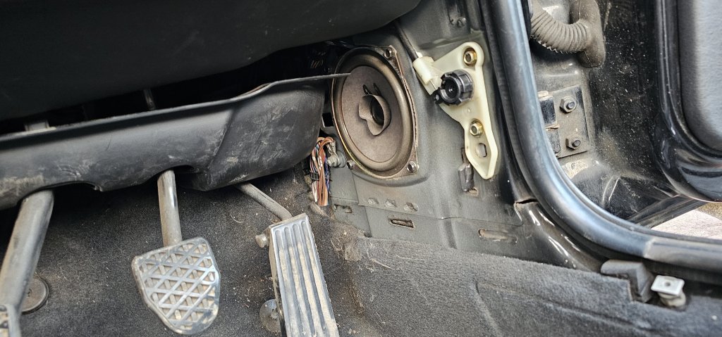

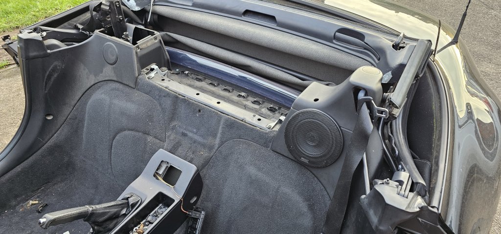

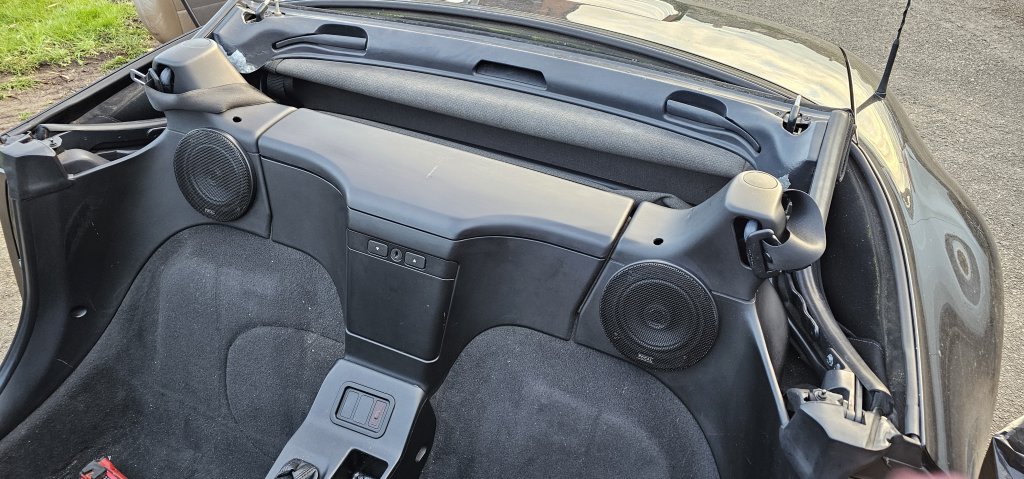

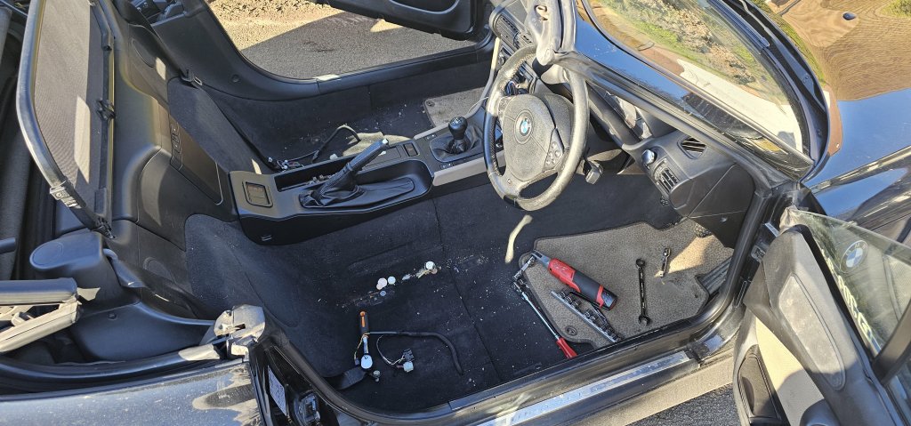

Speakers arrived 8am this morning, got to love Amazon Prime! they were 85quid a pair so not the most expensive but right in the middle of the range, I'm not trying to win a car audio competition, just need an upgrade!
I set about stripping down the interior, seats and all the rear plastics out, managed to find about 3 quid under the seat in change so that paid for breakfast!
Immediately I ran into an issue, obviously the replacement speakers are a lot bigger, across and deeper, and there is next to no room in this area, my car is fitted with the factory folding wind deflector, which I really like, unfortunately though it had to go, I need to remove the brackets to make room! I used a bit of my old tan interior as a test piece to see where to cut the new holes to make the speaker fit.
Eventually found a spot that worked, the back of the speaker is touching the frame of the car and I had to cut a section out of plastic to allow for it to flex outwards but it looks pretty smart when its all back together! significant size difference too!
I'm now on the lookout for some roll hoops and a fixed wind deflector, gutted to lose my old one but needs must! Front speakers is an easy strait swap, plastic covers off, plenty of room in the kick panel to accommodate the size of the new speaker 4 8mm screws out and then reverse with the new one!
The difference is like night and day! took some time to mess with the EQ on my head unit and get them dialled in but the sound is so much better, louder, clearer and much more bass! I could really do with a dedicated subwoofer but I don't want to loose my storage compartment, I'll have to think about a more subtle location for the future. still need to fit the tweeters into the door but I was running out of light and had to get some diner so I put the car back together again, I'll get the tweeters installed tomorrow along with a new pair of handle gaskets I bought a few weeks ago. Overall its been a huge improvement!
