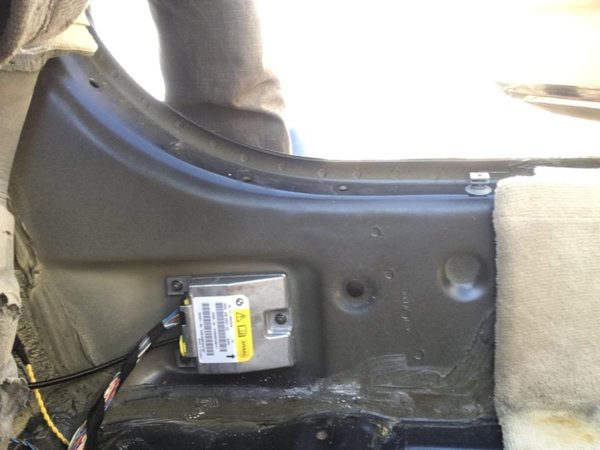

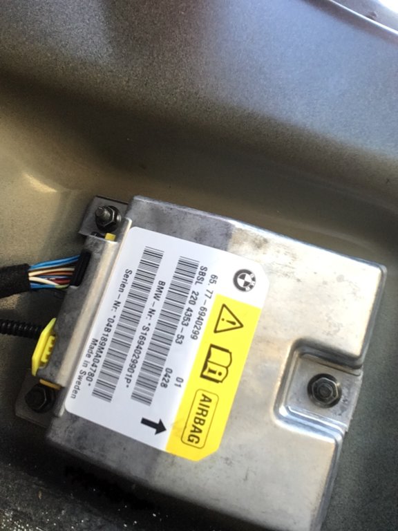

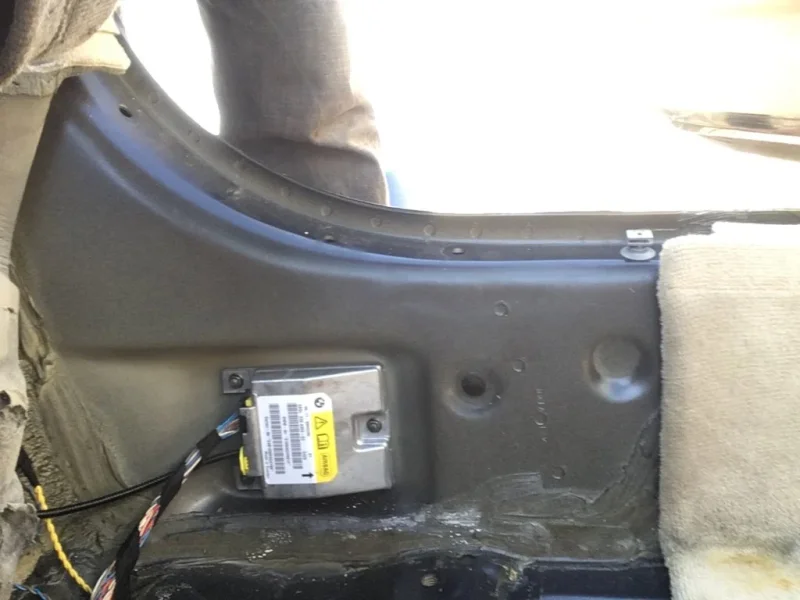

cheers tony,i think there is a crash sensor located around both sill area to detect a side impact,i have ordered one of ebay for a tenner,so will try replacing them one at a time with it,i am wondering if the motor well on the left has filled up with water and at some point got the sensor wet causing the problem,as soon as it stops raining i am taking seats out to clean carpets etc,so will remove plastic trim to try find them.cheers

Taken passenger seat out and found this sensor, was quite wet down there, wires and connetions look ok, will connect seat occupancy emulator tomorrow, clear the airbag fault and will let you know cheers

any progress with the air bag tony,still have to refit my seats,was a bit damp under the carpets at the driver side rear,took the right hand sensor off and took the cover off,no obvious signs,and seemed pretty dry in there
